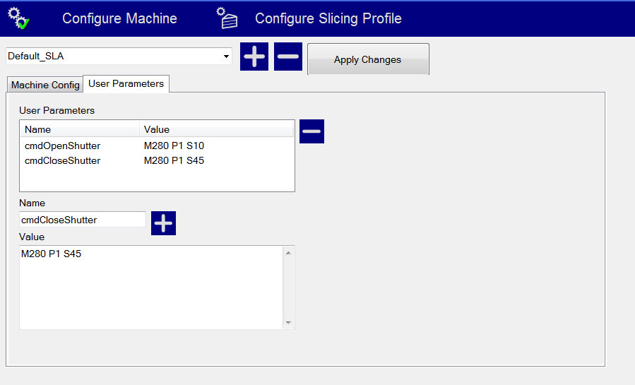

i just see .75 version and have a shutter control. how to configure?? and .... in configure machine, i see a new tab, user parameters. which is intended purpose?

hi, i just tried the new feature and dont work
for example i put M280 P1 S10 and M280 P1 S45 manually and the servo respond opening and closing.
i put the same values in cmdOpenShutter and cmdCloseShutter, but nothing happens. Maybe a syntax error in my side?

I use it seems to work fine. Make sure that you add the code and check the box under settings for shutter control
