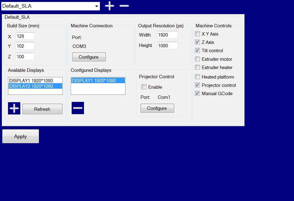

That is great to have an update. It fix many problems and I like the possibilty in the "Control"-panel to choose what you need.
But I have found some bugs, too
1. The manual "Tilt control" give commands in the Z-direction and not in the X-direction. In the automatically generated G-Code of a part it is correct.
2. While connecting the machine, the projector shows a white (or gray) picture. This can be very annoying.
3. In the 3D-View sometimes the scrollbar appears. I didn't find a reason for it.
4. And something just for the look. I think it is usually blue, but after clicking on the "Configur Slicing Profile" and back again, it is gray.

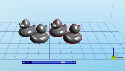

I just want to say Its a great software. 1 thing I want to say is about the un-merged object which shows a void area after slicing(which i have circled). Hope This can be fix and the software will be perfect.. : )
