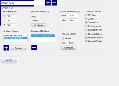

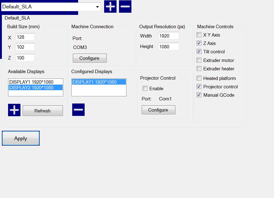

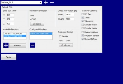

4. And something just for the look. I think it is usually blue, but after clicking on the "Configur Slicing Profile" and back again, it is gray.

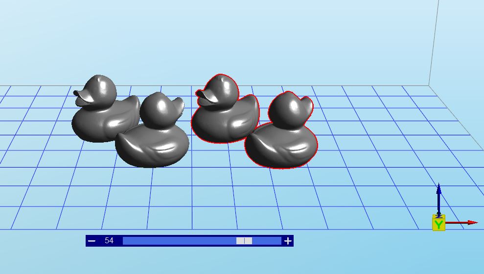

I just want to say Its a great software. 1 thing I want to say is about the un-merged object which shows a void area after slicing(which i have circled). Hope This can be fix and the software will be perfect..
