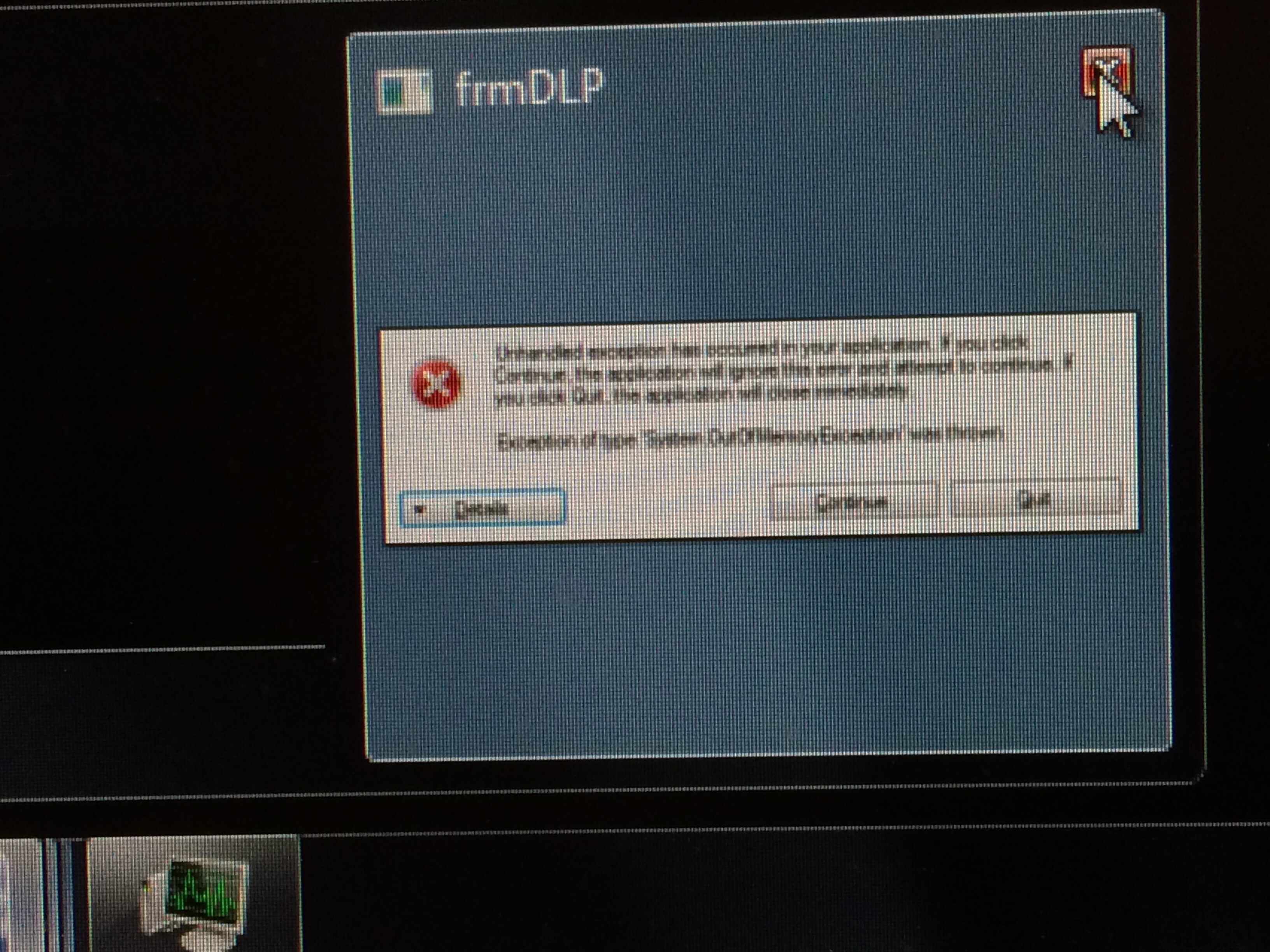

Hello I'm run CW on a windows computer and CW seemed to lock up twice today after about ten minutes into an hour print. The printer thought the program was still going but the projector stop flashing info to it. I was able to move the move to the task bar to show this error. Here is the error I got. And thoughts?

It would not let me open that window. CW was locked up. To get that picture I hovered the mouse over the task bar.
I reboot the computer, printer, and projector in order to get control of the printer again.
I opened the task manager and the physical memory was 62% (it's an older computer) with only CW running. I checked the processes and found that google chrome, and a couple more programs were opening on the startup. So I turned them off and rebooted. That dropped the usage to 38% with CW open. That was at 2 am last night. I'm gonna run a test this morning to see if that fixed it.

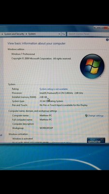

The print went farther but crash again. Here is a screen shot of what the computer is. It has 3 sticks of 1 gig ram so I'm gonna up th ram to 6 or 8 gigs

You're running a 32 bit system. You will only get 3 usable gb of RAM, even if you put in more than that. I hope you get the problem sorted soon.
