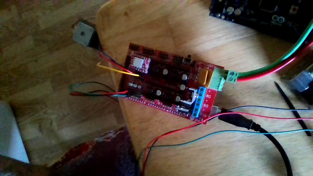

hey all got the motors to move but only in one way ..unless I hold down the endstop then it will go down and my ramps board used to have the led on but now nothing?????? hers my pic and im using sprinter because I cant get marlin to install?

i received a chinese end stops with two wires with the position changed. i remember having the same problem as you. check in ramps and your end stops to match vcc, gnd and signal.
