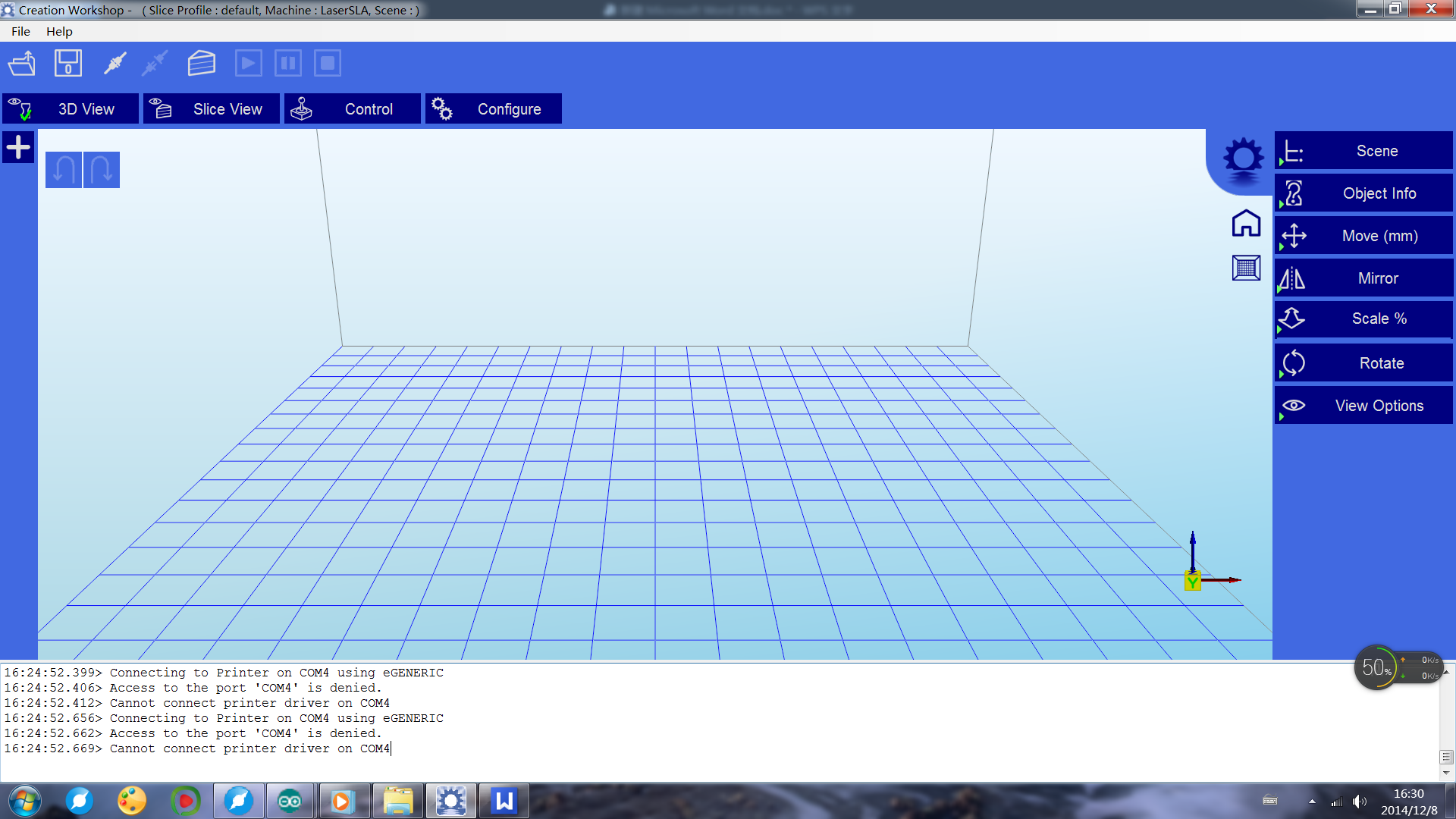

16:24:24.411> Cannot connect printer driver on COM4
16:24:25.017> Connecting to Printer on COM4 using eGENERIC

you do not say what you are connecting , but you are trying to connect both a dlp projector and your controller board to com4
i.e both the same usb ports .. this will lock up the usb
machine connection = your arduino controller
projector control = your dlp projector
if you have any further problems please state what controller and dlp you are using

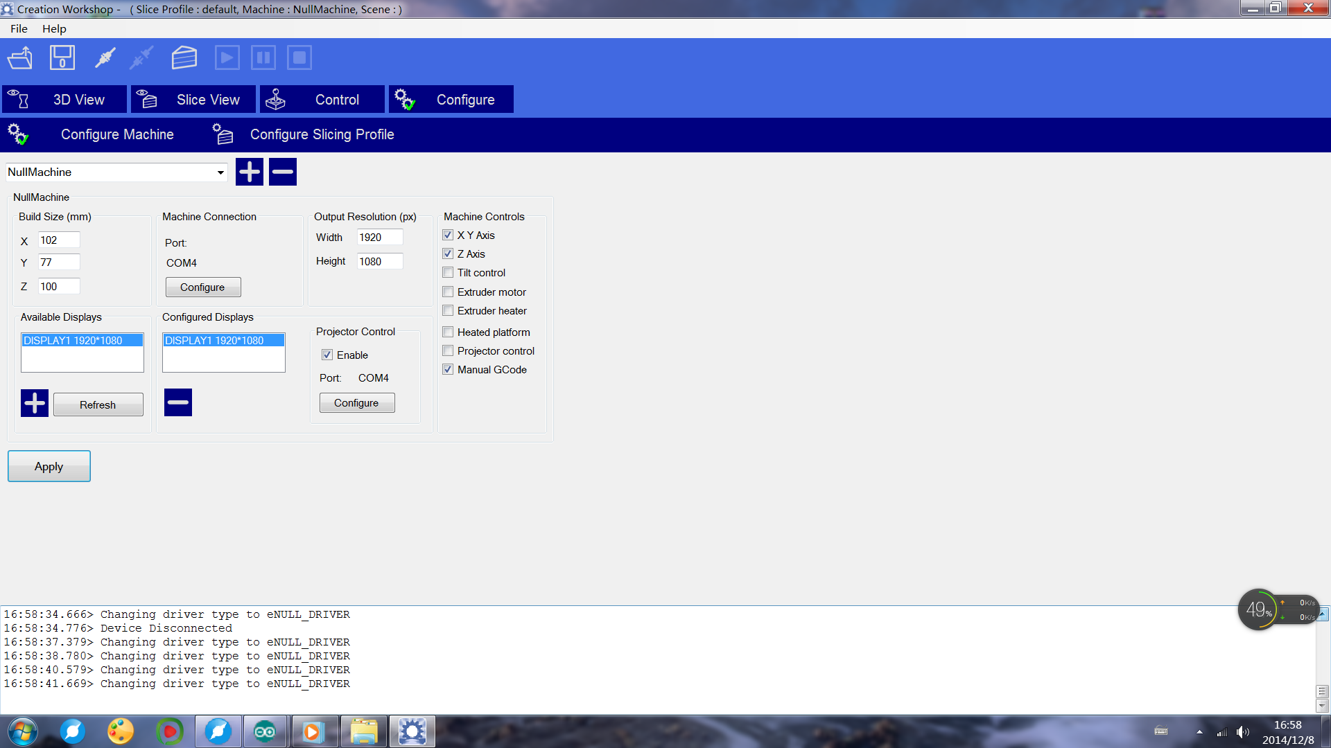

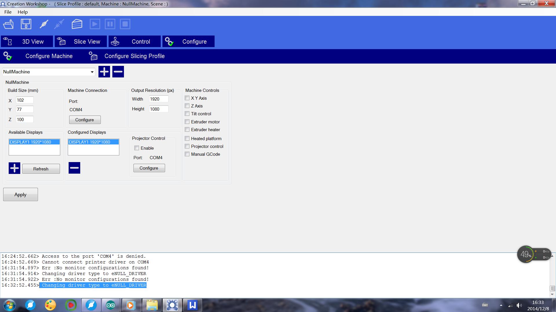

Can you post a screenshot of the window that opens when you click "Configure" under the "Machine Connection"?
Some other tips:
Make sure you use the eGENERIC driver, not NullMachine. Also, keep the "Enable" button under "Projector Control" unchecked.
If I had to guess your problem, it's that you do not have the correct firmware on your Arduino, or the wrong baud rate. What firmware are you using? Do you have a link to it?
Some other tips:

Re: I need some help!
The Null machine is used for 'local testing' while not connected to a machine. Use the DeafultMachine profile instead.
