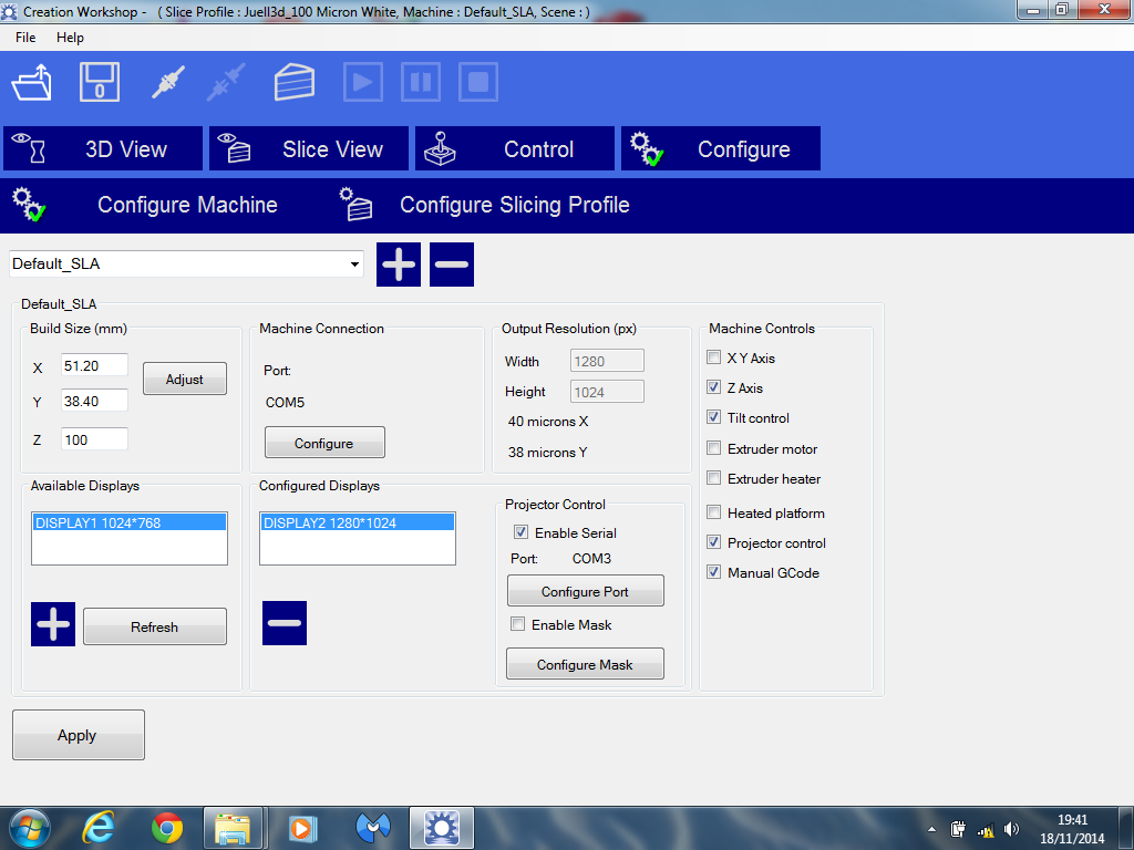

Postby dalaura10 » Wed Nov 19, 2014 7:22 pm
[img]config%20machine.png[/img]

Re: How to move CW stepper motors?
Postby dalaura10 » Wed Nov 19, 2014 7:35 pm
Cncbasher
The doors of both the arduino as in the CW are set on COM5, but the leds of the arduino does not light up when a signal is sent by the CW.
as a parent, is correct, because the engines in another progarma function normally.
