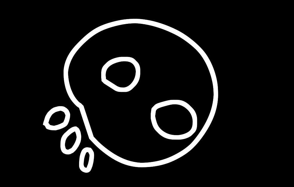

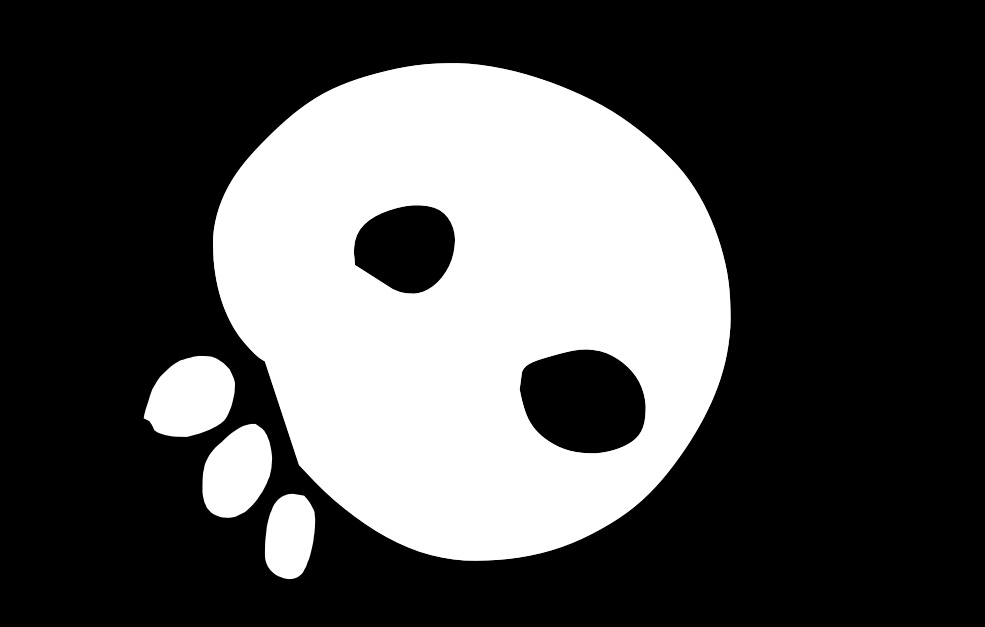

Take a slice and select the white areas
Then stroke the selection, towards the inside, set the stroke pixels as wide as you want for the walls
Advantages are that you don't need to edit the original 3d model (extra GEO and headache)
and that you can change the wall thickness for printing at different scales on the fly.
