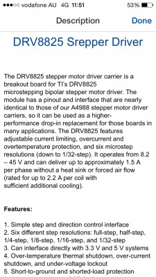

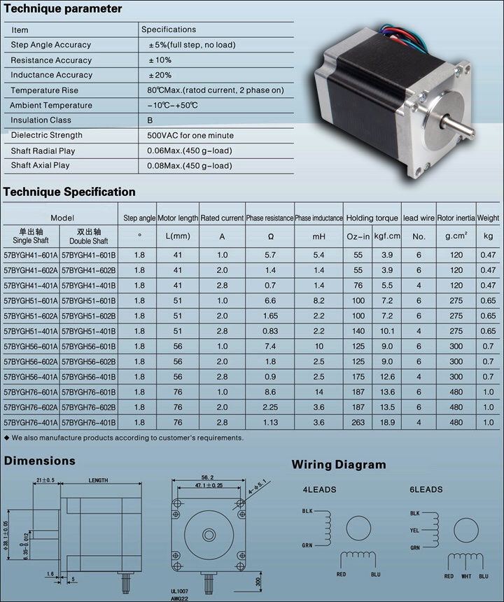

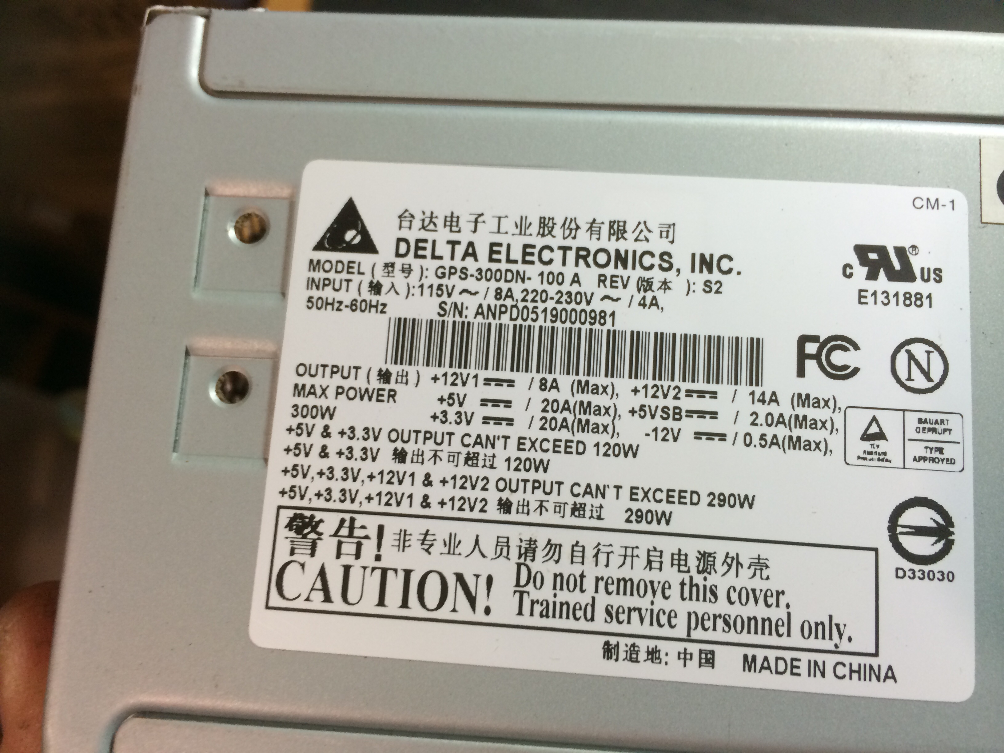

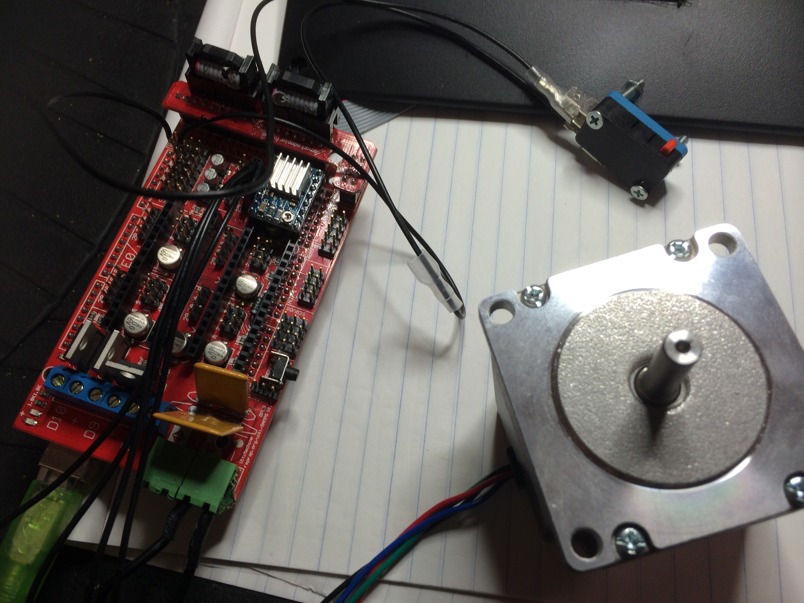

Here are some details on the set up also my stepper is the 263oz stepper
