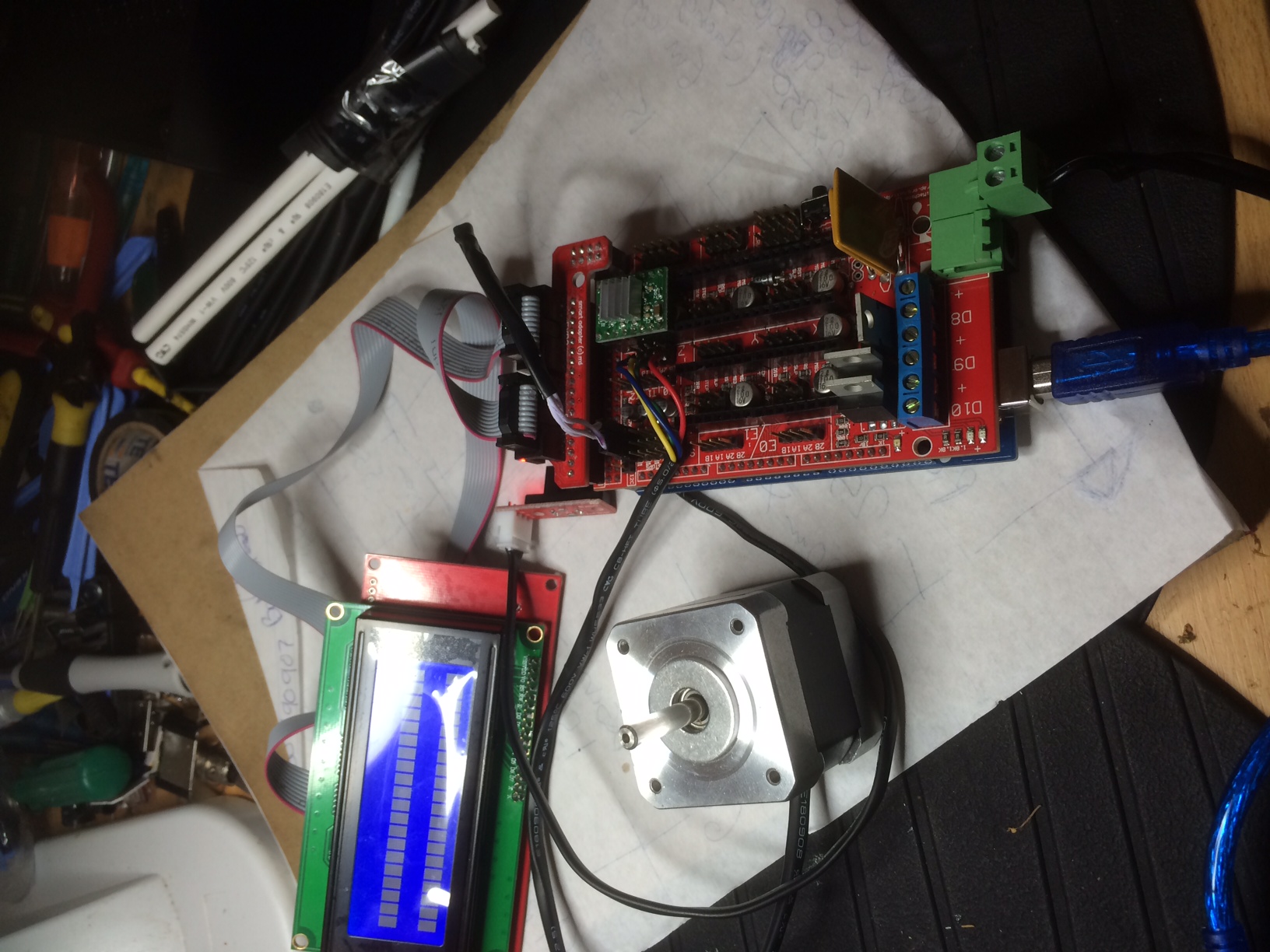

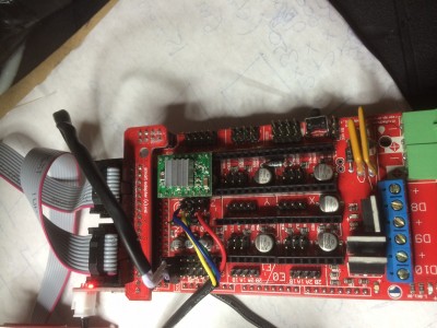

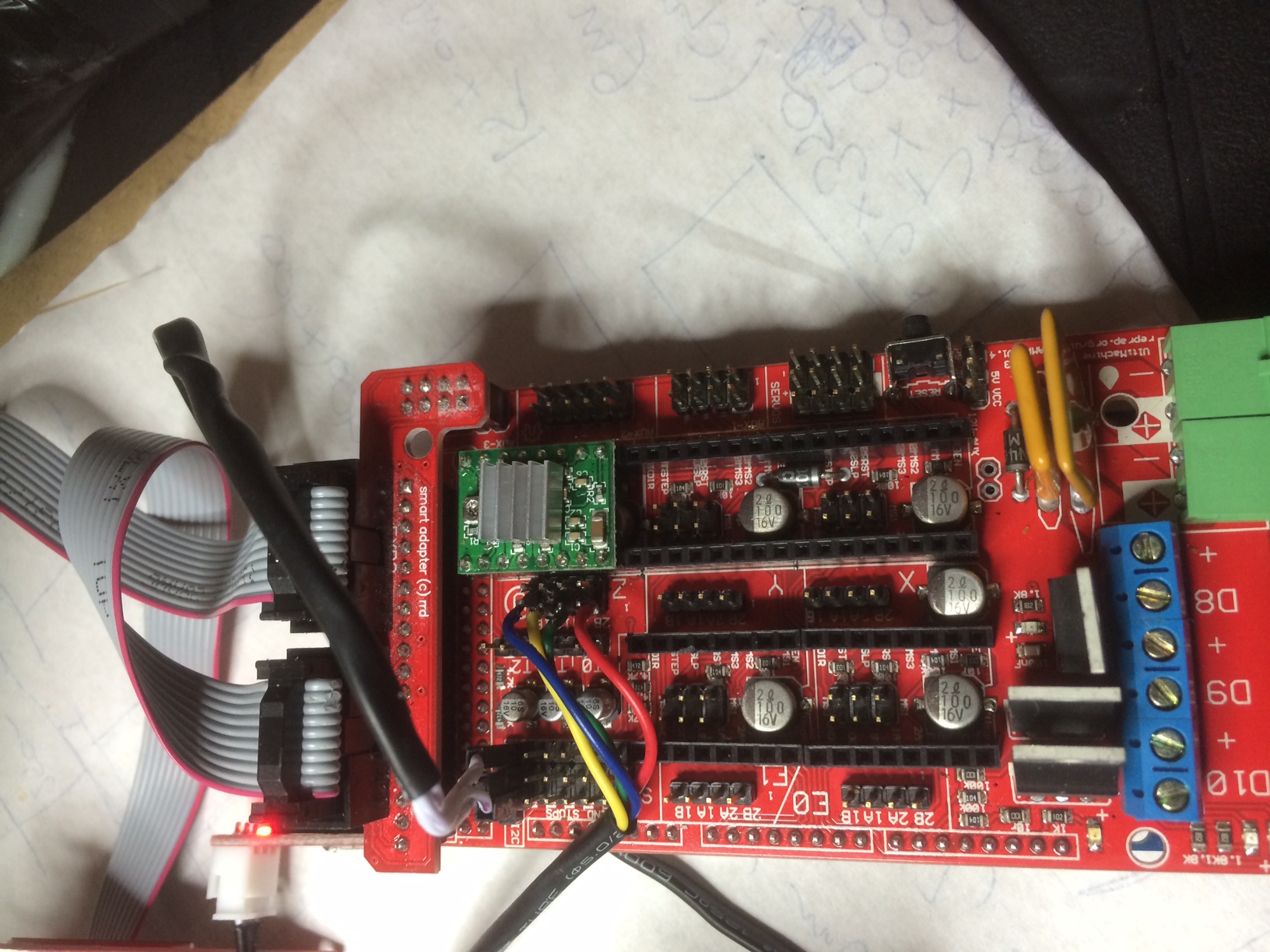

Hi guys im having dramas connecting to my control board im thinking i may need more drivers??
i can program the board fine, i tested this by installing the test firm ware and all was well
but when i connect CW there is nothing also when i connect Grbl controller i get No data from COM port after connect. Expecting Grbl version string.
i have tried several several firmware versions including firmware versions know to work with my setup and still nothing.. any suggestions welcomed
here are some pics of my set up

How much experience in motion control do you have? This will help get appropriate answers.
Have you made the motors turn with any other software? I used Pronterface during hardware debug because I also have a RepRap and it helps to sort if the problem is with one program or another, or a setup issue.
Are the max step rates set to a sane value in firmware?
Did you use the "connect" function in CW before trying to jog?
Are you on your own or do you know someone else who has a working RepRap or other device using Arduino/steppers?

Have you tried using Marlin or Sprinter? It will work once homed that is the key for any of the firmware.
If you do try or have tried Marlin and your endstop does not trigger you would need to configure your Pins Here is a basic guide that should help you out.
