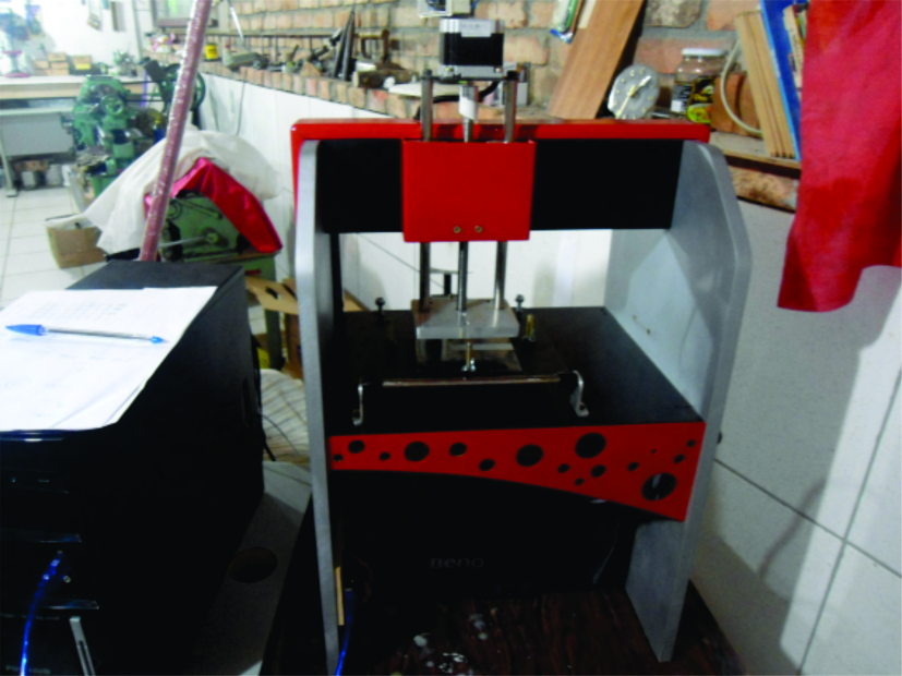

My 3D printer is almost ready, but so far I could not make it work with the CW 36 or CW 41, I can only some movements with the realese 03.
I am now trying to install with the firmaware Marlin, but I'm not thinking that defines the step pins and direction to take, I've been searching the forum and did not find, if anyone knows please let me pass.
Some photos of the progress of the project, it differs from others with respect to the Z axis that is centered on the tank and not in a vertical column as usually see.

Unfortunately your photos still aren't showing up... Try uploading them to , then link them.
Since you are using an Arduino Uno, Marlin will not fit on the board (Not enough memory for the firmware).
Honestly, at this point I'd recommend purchasing more standard electronics. Get yourself an Arduino Mega, a RAMPs 1.4 shield, and some stepper drivers (enough for each of your motors). We'll be able to help you much more easily.
