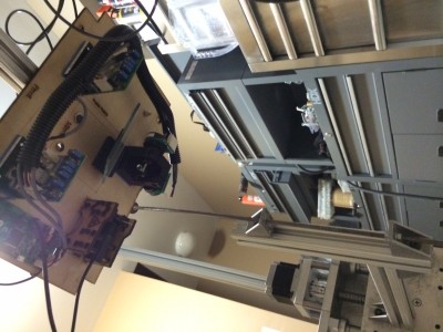

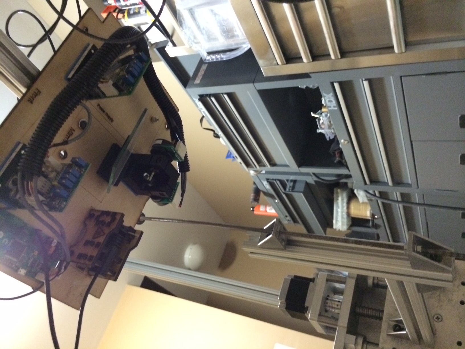

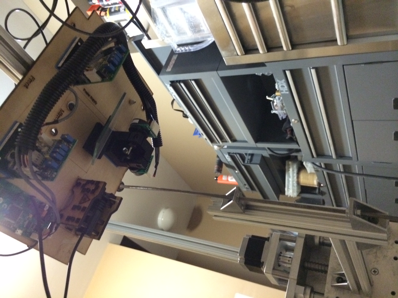

System is setup. I have all of the electronics mounted on top with an adjustable z-axis. Figured this would be the best way to increase build size or focus the laser.
