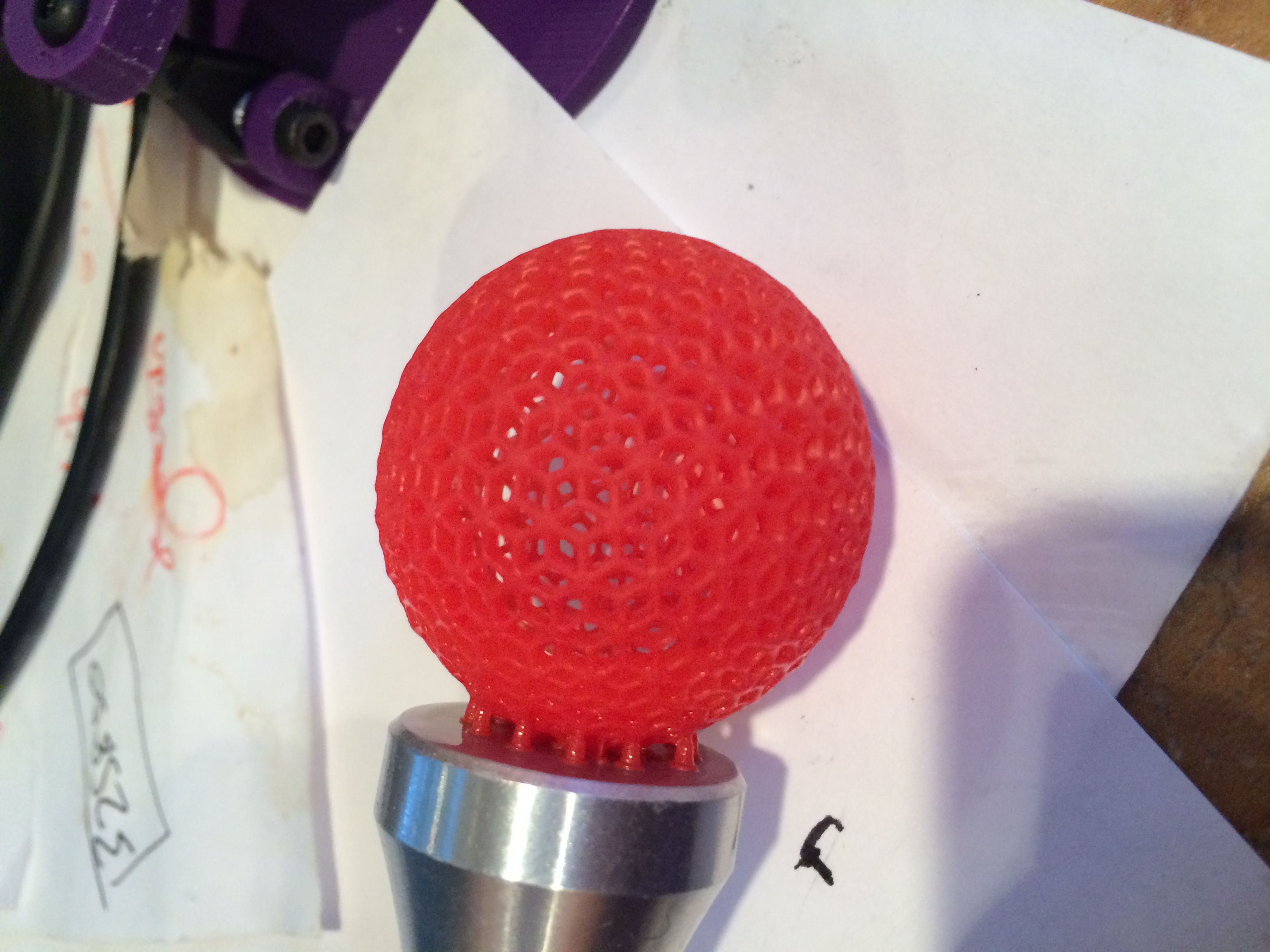

You may also have an issue with light bleeding -- it causes your edges to be fuzzy, since the UV is refracting a further distance throughout your resin.
Blue and purple tend to have the worst light bleeding (So I've heard). I'd give red or yellow a try (With the same settings as you currently have) to test that! Good luck!
The red G+ is easier to print than the blue. This part used the same slice parameters and came out pretty nice looking. It was a little soft, is that normal until it is post treated with UV?
