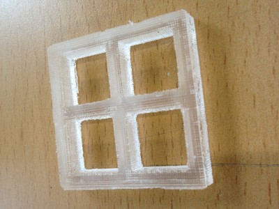

I purchased continuous wave 405nm diode laser (up to 100mW) and galvo set (30 kpps, mirror+motor+driver set).
It works ok but the surface of printed part has kind of 'cross stripes' and its very regular in shape. (please see the pic)
It happens when I use this super-focused laser which has 20 microns of beam size (this is much smaller in beam size than that of other SLA lasers).
Galvo resolution spec is more than enough to draw continuous line so I think it is related to the firmware...but have no idea how I can remove those 'dots'
Any ideas??? Please help..
