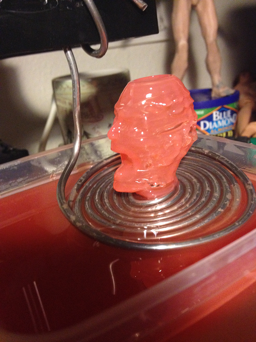

Hey here is what I have so far... Extremely blobby even though the model is hollowed out. I increased the exposure time to 8 seconds per layer but it still has trouble curing. I'm not sure if its the resin or projector... The resin is SubSF for littleRP and the projector is a toshiba TW90. Will try longer curing time when I get home from work tonight.

How thin are your walls? They look really sparse in that photo...
