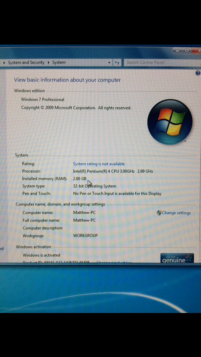

The print went farther but crash again. Here is a screen shot of what the computer is. It has 3 sticks of 1 gig ram so I'm gonna up th ram to 6 or 8 gigs

You're running a 32 bit system. You will only get 3 usable gb of RAM, even if you put in more than that. I hope you get the problem sorted soon.

Fixed my problems by buying a new computer for $200
Should have done that four days ago
