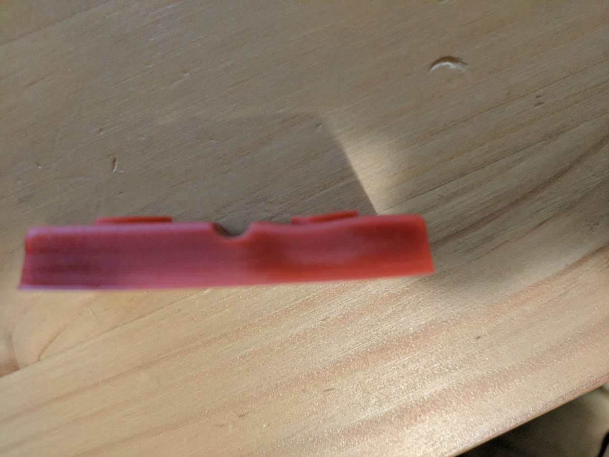

1. The main issue. After printing for about 6 hours, I now have a band that goes across my print area, where if I print out a full print, it is shrunken in height at that area. I started a print and cancelled it after two layers- the build plate had a visible band there where resin did not cure... Did I melt something, or melt part of my projector? - Attachement showing a full print with a shrunken bit. Both sides should be identical and flat. The undercured? band makes it curved. (I did not replace my Teflon in the vat yet. Could that be related?) - Photo attached of a result. It's blurry, but it is the best photo I have that shows the issue, quite clearly. Sorry for the low quality- it's close to midnight and I am being lazy
