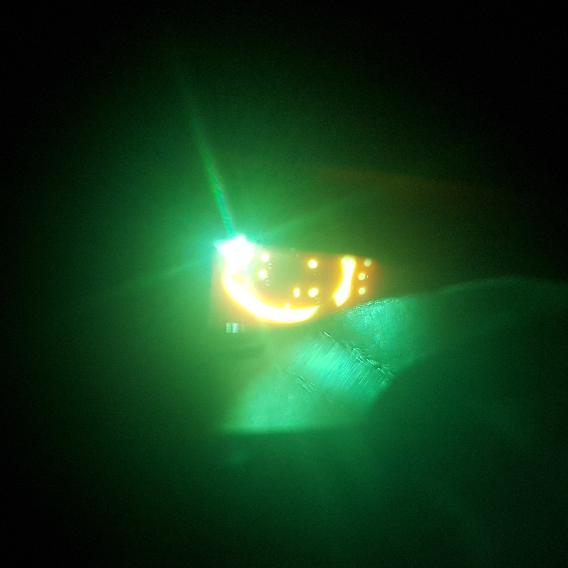

I can't speak for the projector, I don't think yours needed modding but I'm only going off memory. This image is of my printer and your projection should look like this on the bottom of your vat:
