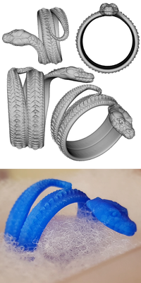

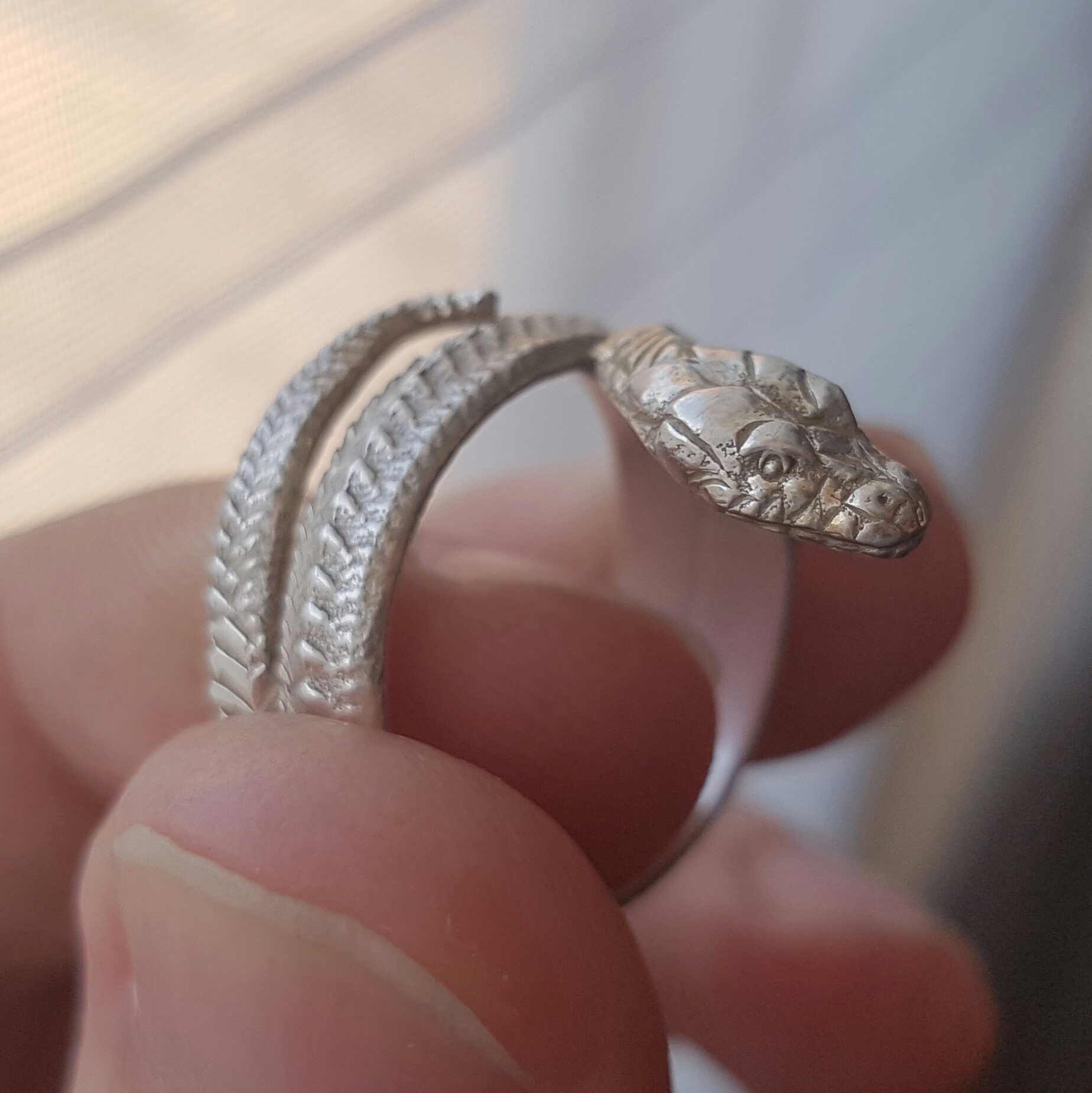

I aim to do high detail sculpts in zbrush so the higher resolution(?) i can get the better, 25 microns is better than the 30 I've seen available and at 1/4 the price. This was an example I made to test the capability of a 16 micron professional wax printer. The final pic isn't ideal unfortunately but the ring came out great.
I'm sure some detail would be lost going from 16 to 25 microns but I could work with that, it would be good to see how the littleRP handles my snake ring.
