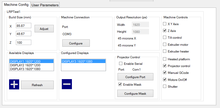

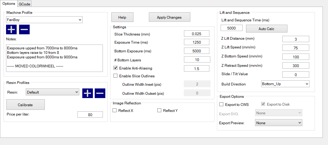

I do not think anything is left at the default settings. My settings are as follows:
The mask is an image used to filter out a measure of the light in certain areas of the projected images. Look at these threads here, they explain it better than I can. It's basically a means of making the light distribution a little more even.
I think I've had some improvement using the mask, but it's creating these weird scan lines. I can see the lines in the projected image when it's blown up, and now because of the super high reactivity of the FTD resin, the prints are picking up a subtle wavy surface.

I'm about to run a test print with about half the cure time (1250 -> 500) and without the mask. The more I read about this stuff, the more it seems like this stuff is even more sensitive than I thought. This stuff is supposed to work and make clean prints without adding more pigment and other people have had success, so there's most likely some optimum combination of settings that I just haven't hit yet.
