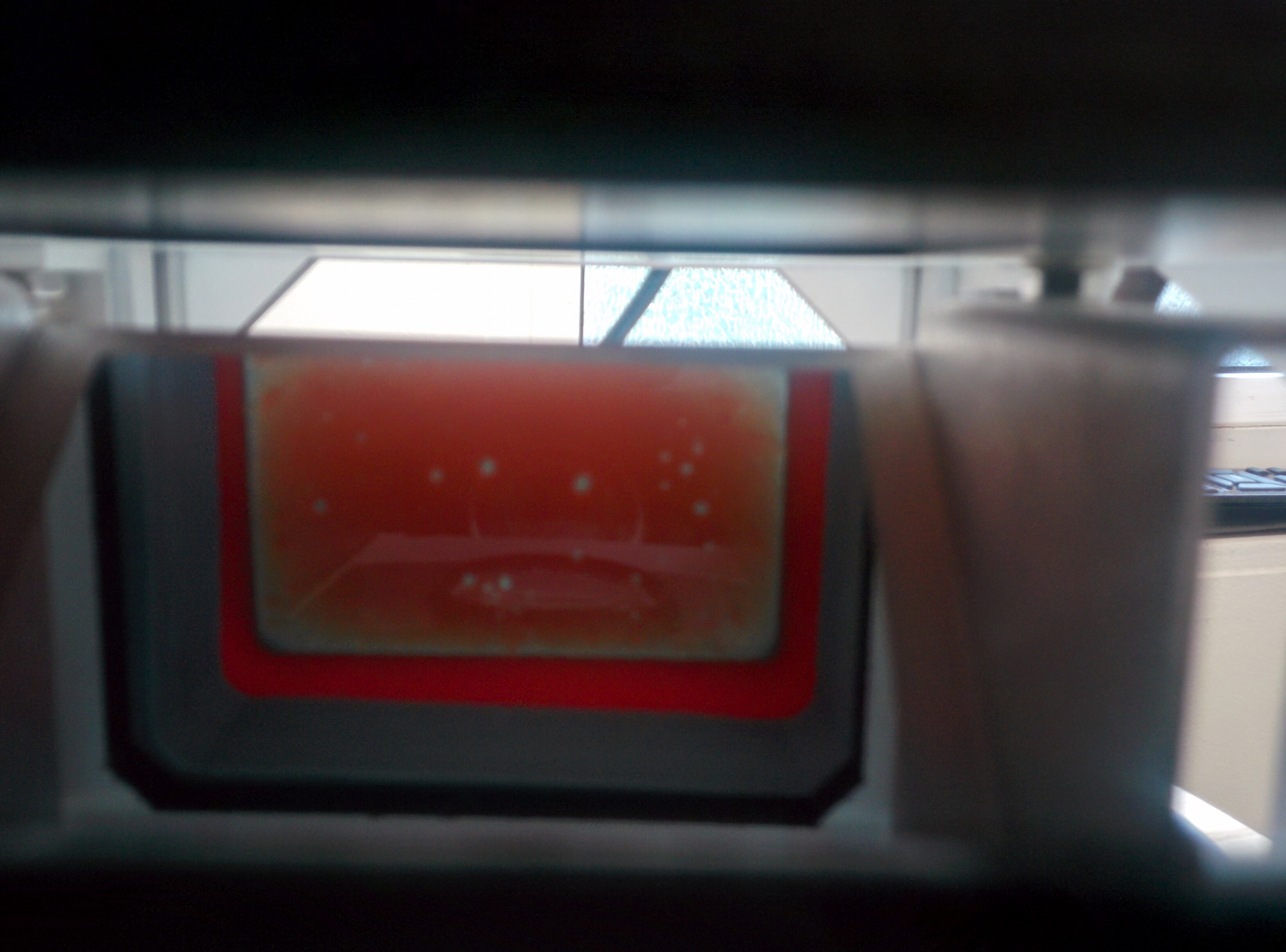

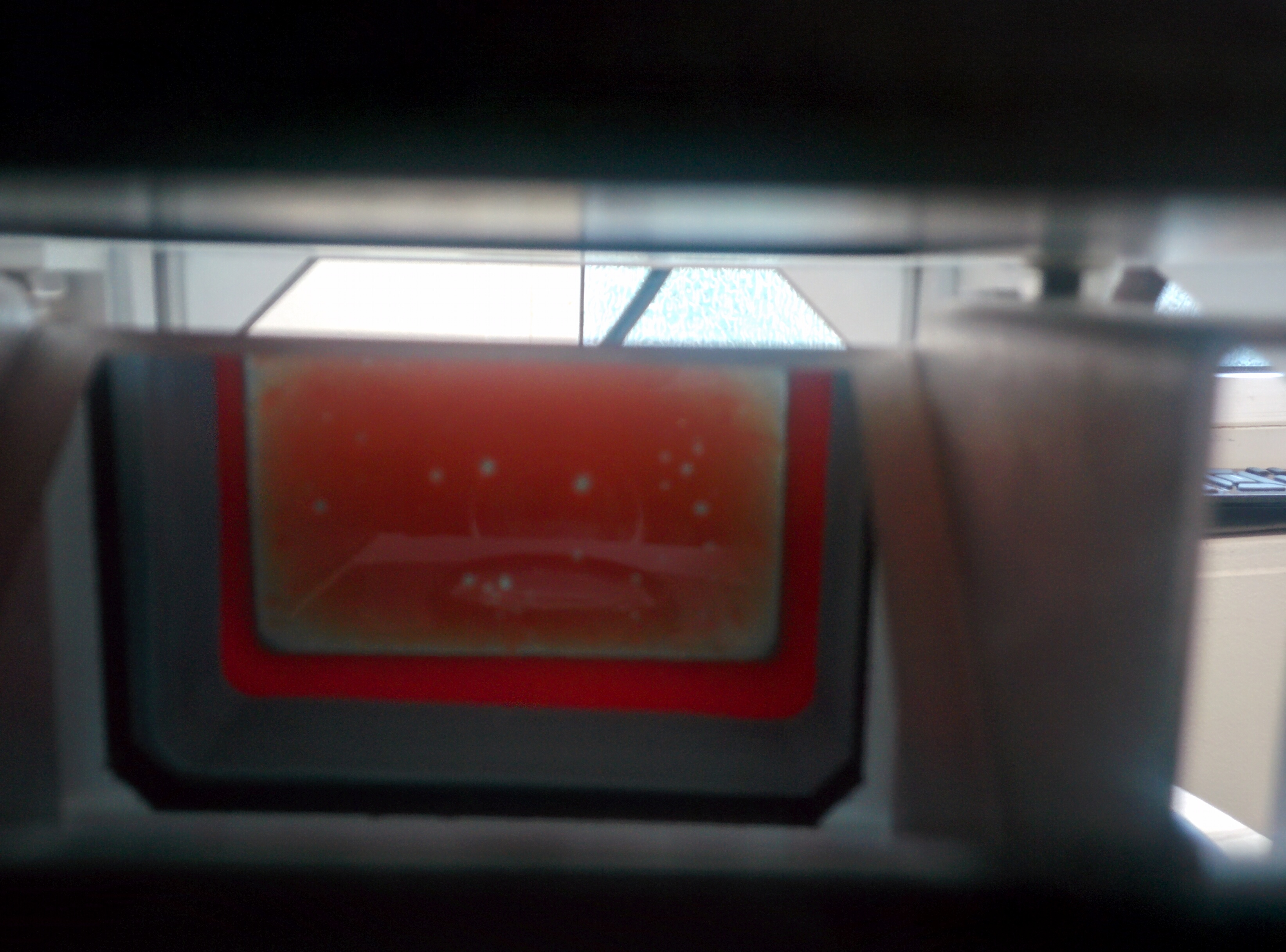

How do I zero the build plate with the default build plate? It's not that big.

Re: LittleRP proving to be a waste of time!
see the second to last paragraph of my first post, it covers diluting resin pigment.
Increase the tension on your fep, it appears to be low (make sure the gasket and FEP are tightly clamped, the gaskets should be fully crushed).
you may need to raise you vats zero position a bit. You will have to consult the LittleRP documentation for this but try increasing the vat tension first
HTL
