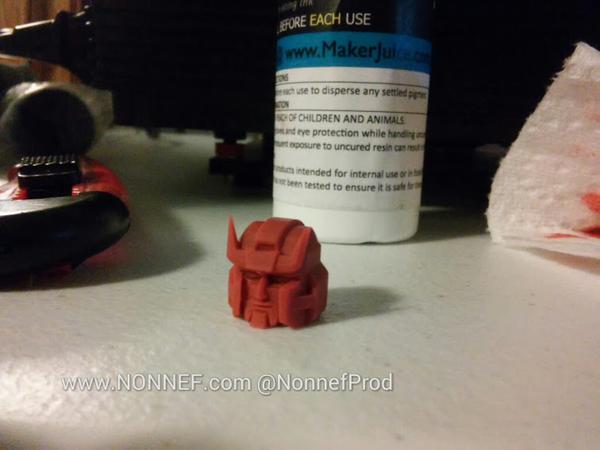

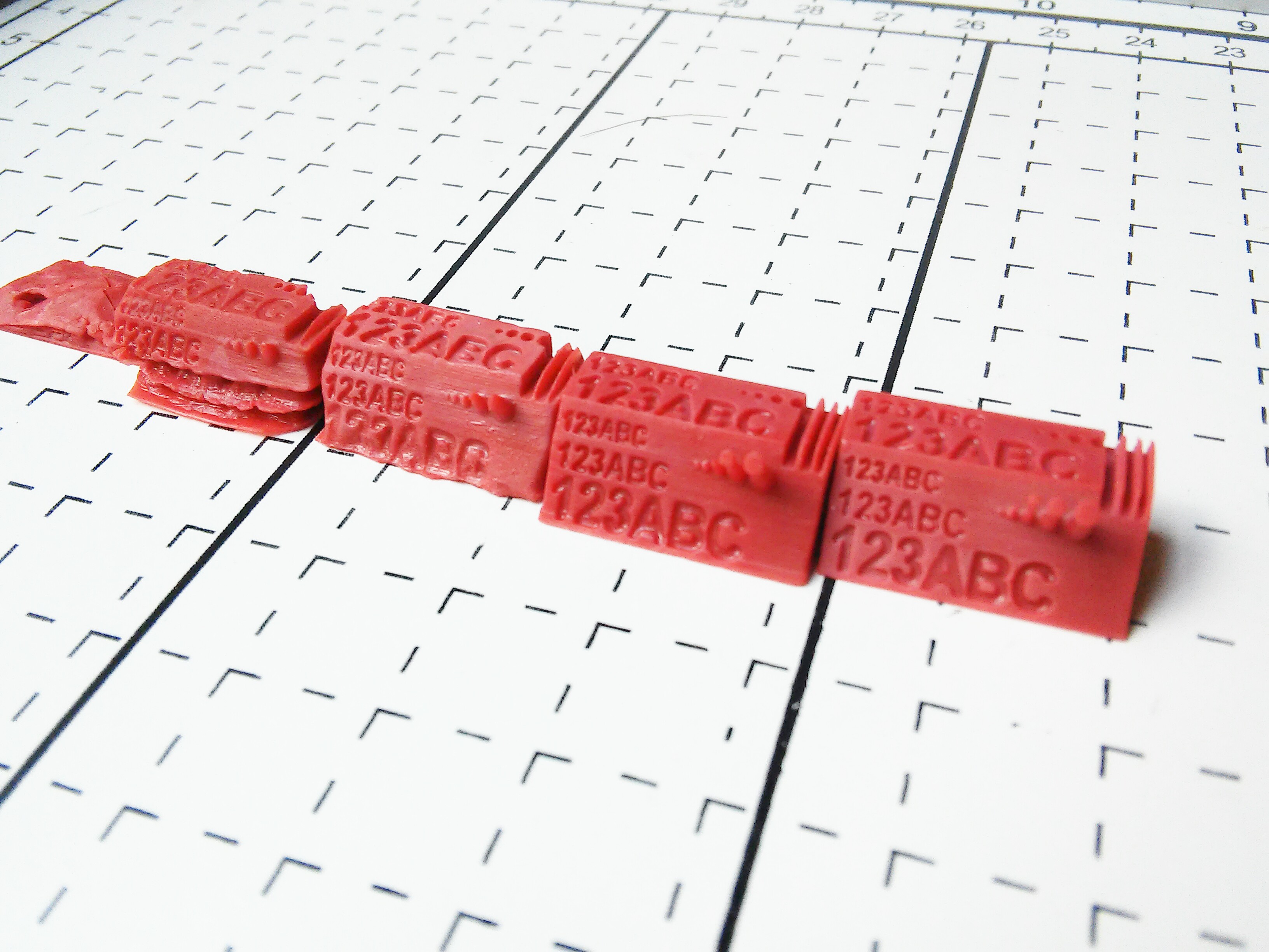

Ran my first prints from my LittleRP today and they kept coming out under exposed.
I started with the recommended 3500ms/5000ms setting but kept having to bump them up to get anything to work. You can see the final print turned out good, but I'm sitting on 8500ms/9500ms to get it to that, which seems much higher than everything I'm reading. And it's still a bit under exposed.

Because you can see the first few prints on mine at those setting didn't remotely cure.

Increasing the brightness to 100% only gave me a solid block of resin. Even at 65% it turned most of the resin to a gummy mess.
Reset the projector to stock settings and still having the same problem. It's printing fine as long as I keep the exposure high. Currently at 9000ms/10000ms and that seems to be my thresh hold. Any lower and I get under cured resin.
