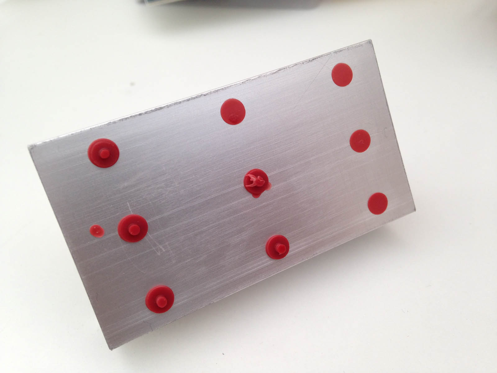

First I had some trouble to find a good curing time (I user MakerJuice SubSF for LittleRP) - I had to use longer times than the ones suggested 5000 instead of 3500).

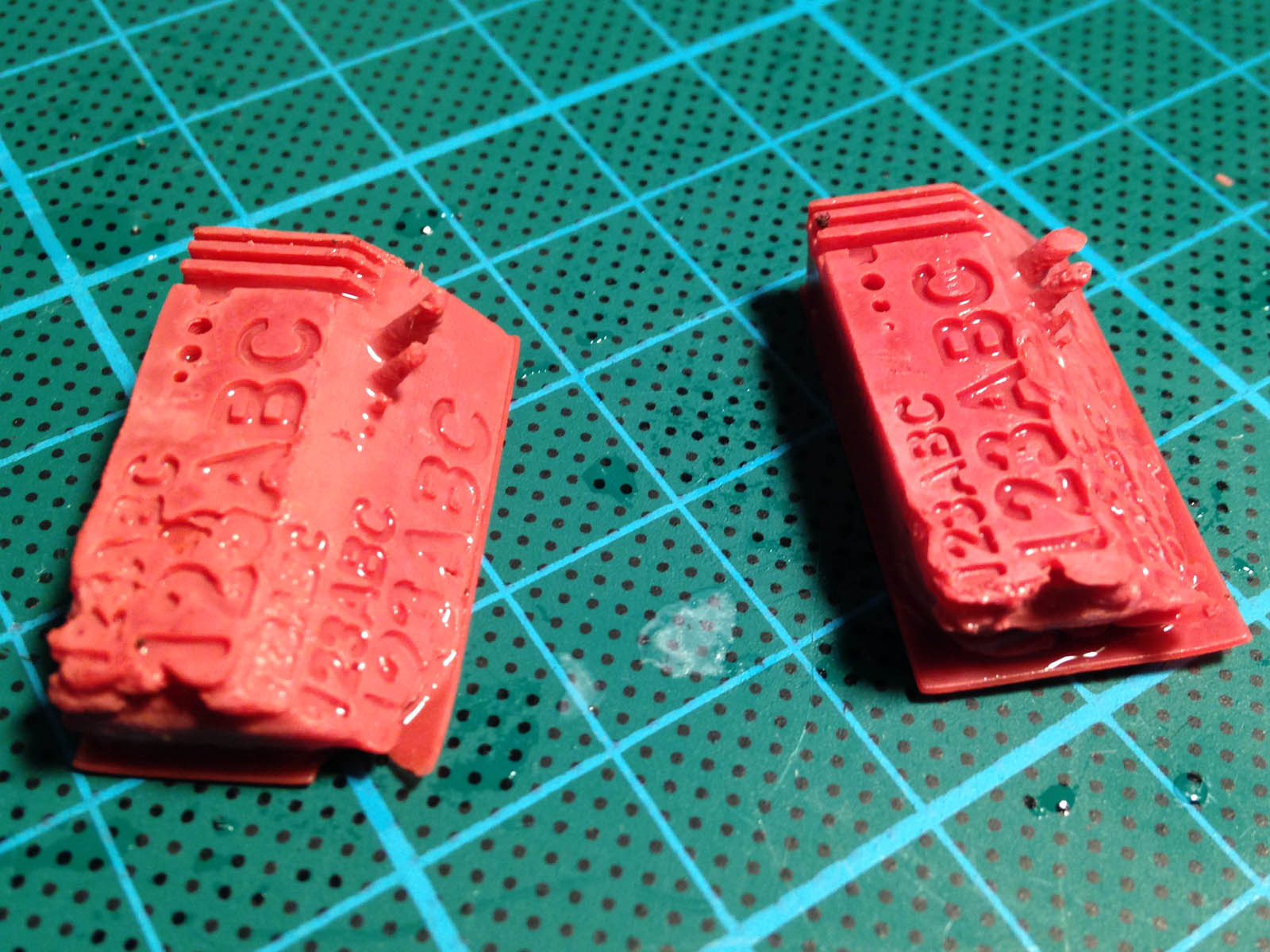

The first print was a calibration pattern and only one half of the dots got well.
As I used larger curing times the prints went better but still had some distortions in one corner.

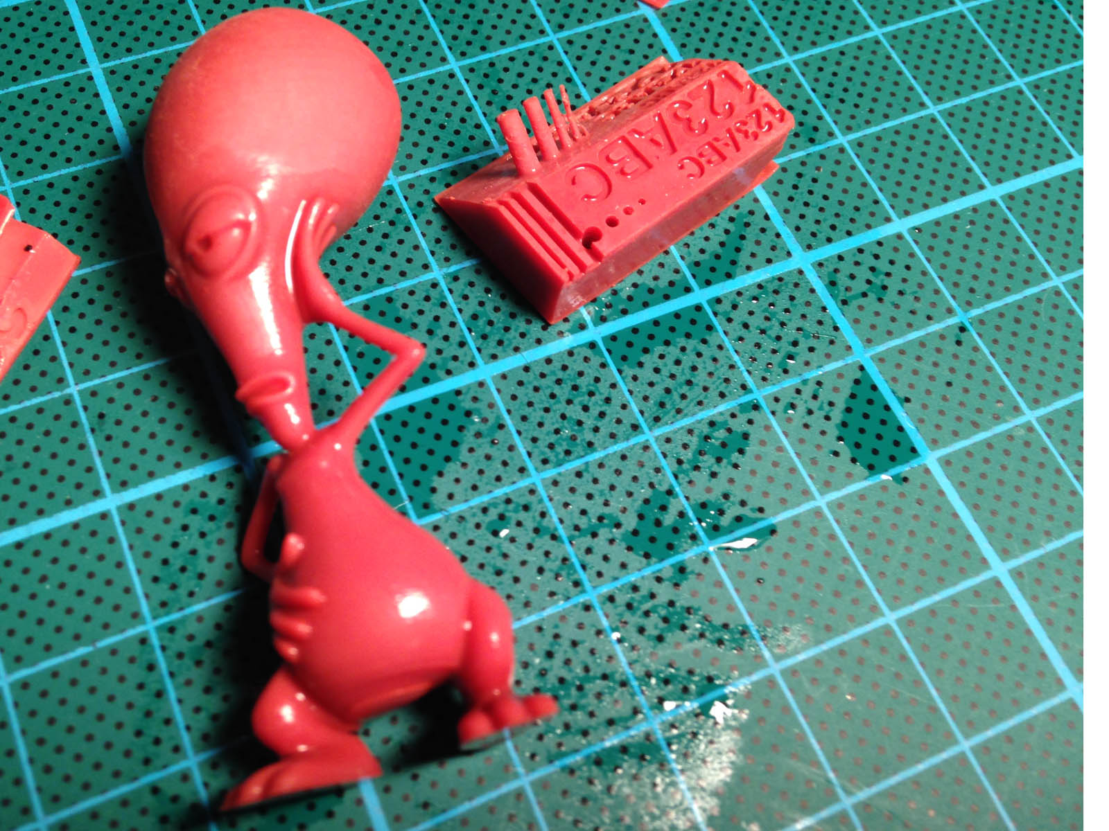

I managed to print a really good looking alien and a nearly good calibration brick - it still has some hole in one corner.
1. Any comments on the prints? Should I use even more time? How do I know if the time is too long?
The calibration dots are a harder print because the acer 1080p projectors are a little uneven, so a longer cure is the way to get it to come out.
Don't worry about the holes and lines on the calibration rectangle those are mainly for resin testing, worry about having the cylinders come out intact, so you will want a little more cure time yet to achieve this.
