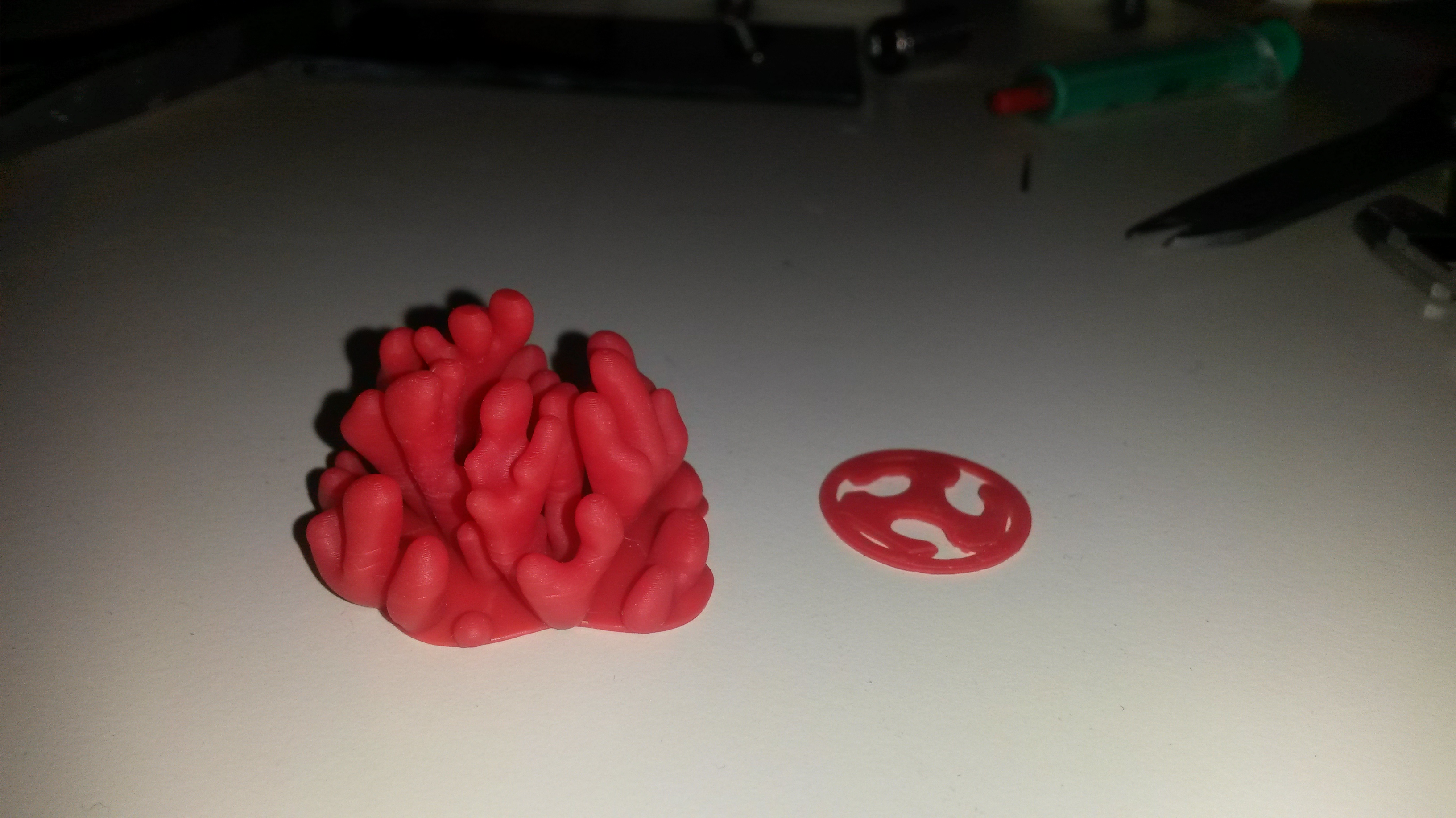

EDIT #3: Would you mind posting a pic of your flex vat print?
