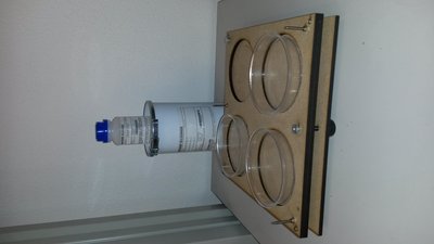

I started recoating petridishes today with Wacker Elastosil RT 601, and my new leveling table, that I will of course share with you, when I am in my workshop again (in case anybody is interested
