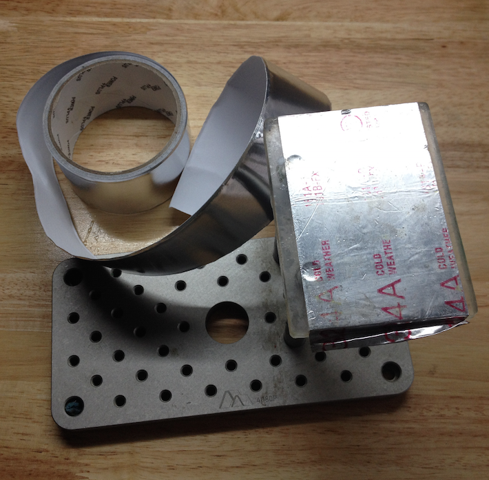

I have been using the aluminum foil tape over the built plate. Sand it lightly, once the print is complete remove the tape first.

So these seems to be the best solution , as I tried the aluminum tape, and it's very hard to get a good surface, and also
it's means more expenses in money and time.
