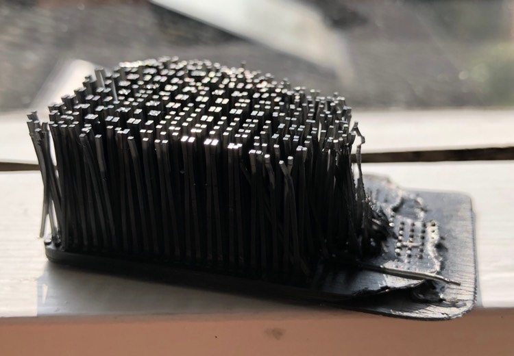

Anyway, I'd started a thread about not being able to print reliably across the build plate as shown here:
I built a UV detector using an Arduino and a UVM-30A sensor module and I've used it's readings to play around with projector masks in nanodlp to even out the UV across the build plate which seems to have solved the problem:
Almost, the near-right corner is still a little under exposed but it's definitely better.
