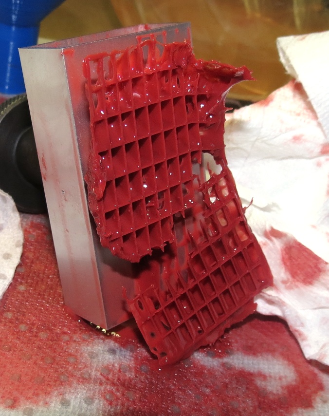

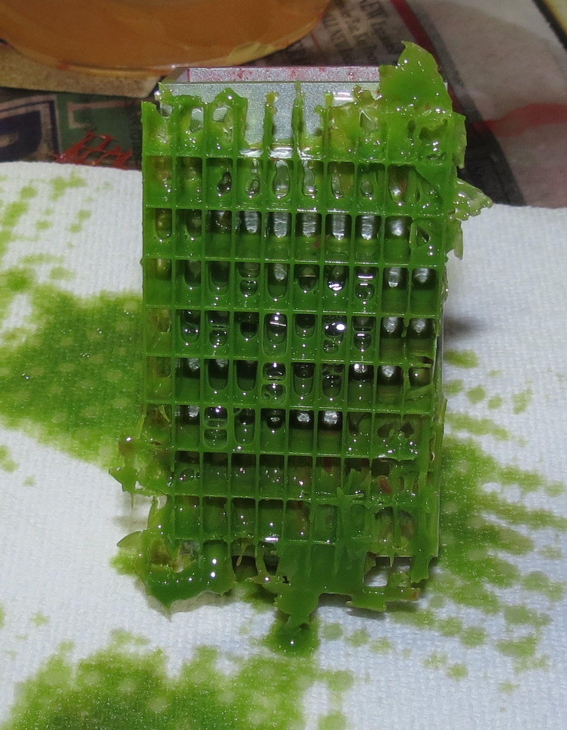

Here is the last test print using the old/bad/red resin and the new test print with the green resin.  Both Maker Juice SF.  Notice that with the good print, I was able to print beyond the edge of the build plate, because the print was one huge piece.  The red print had one entire section that just dropped off; the remaining section was only attached to part of the build plate.  The green print was attached to the build plate almost uniformly.
Lesson? Contaminated resin can make you crazy.
