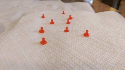

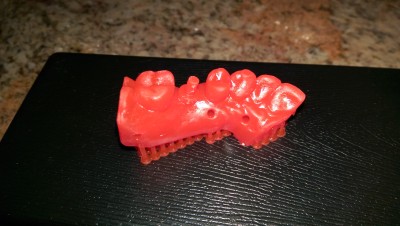

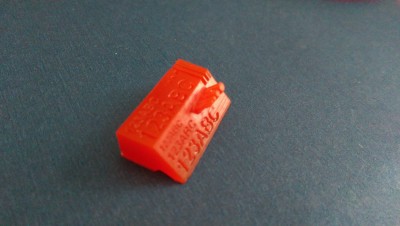

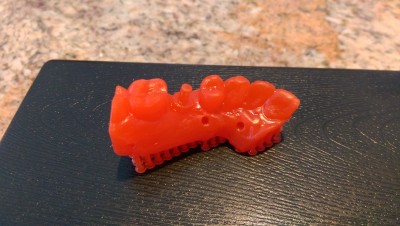

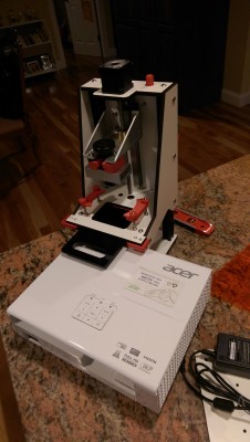

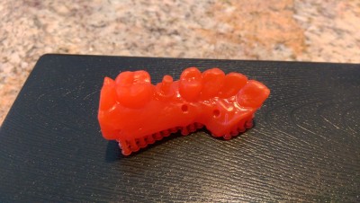

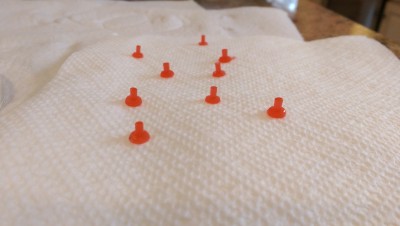

			Printing with funtodo resin industrial blend. My initial settings were too high and the resin stuck to and ripped the pdms layer. I changed my settings to the following: 4500 for first 8 layers, 800 for rest of layers with 50 micron z resolution. This seems to be working out fine although I think I may be able to decrease the time a little bit. I printed the calibration from the littlerp website and then printed a dental model. Measuring them they are both slightly oversized. The cylinders should be 2mm (as measured in netfabb) an they are about 2.2-2.3 mm. They are mostly round and straight. The dental model that has the cylinder should be 2.2mm and it is closer to 2.8. Otherwise the prints all look pretty good.
So where do I go from here? I am thinking I need to reduce the exposure time and work on making sure the projector is in perfect focus. I will grab better photos after the weekend, my dslr/macro setup is at my office.
