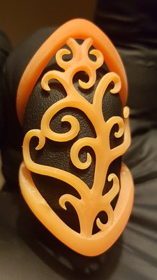

Thanks to the people in this forum I'm actually having success printing but I have one more problem.

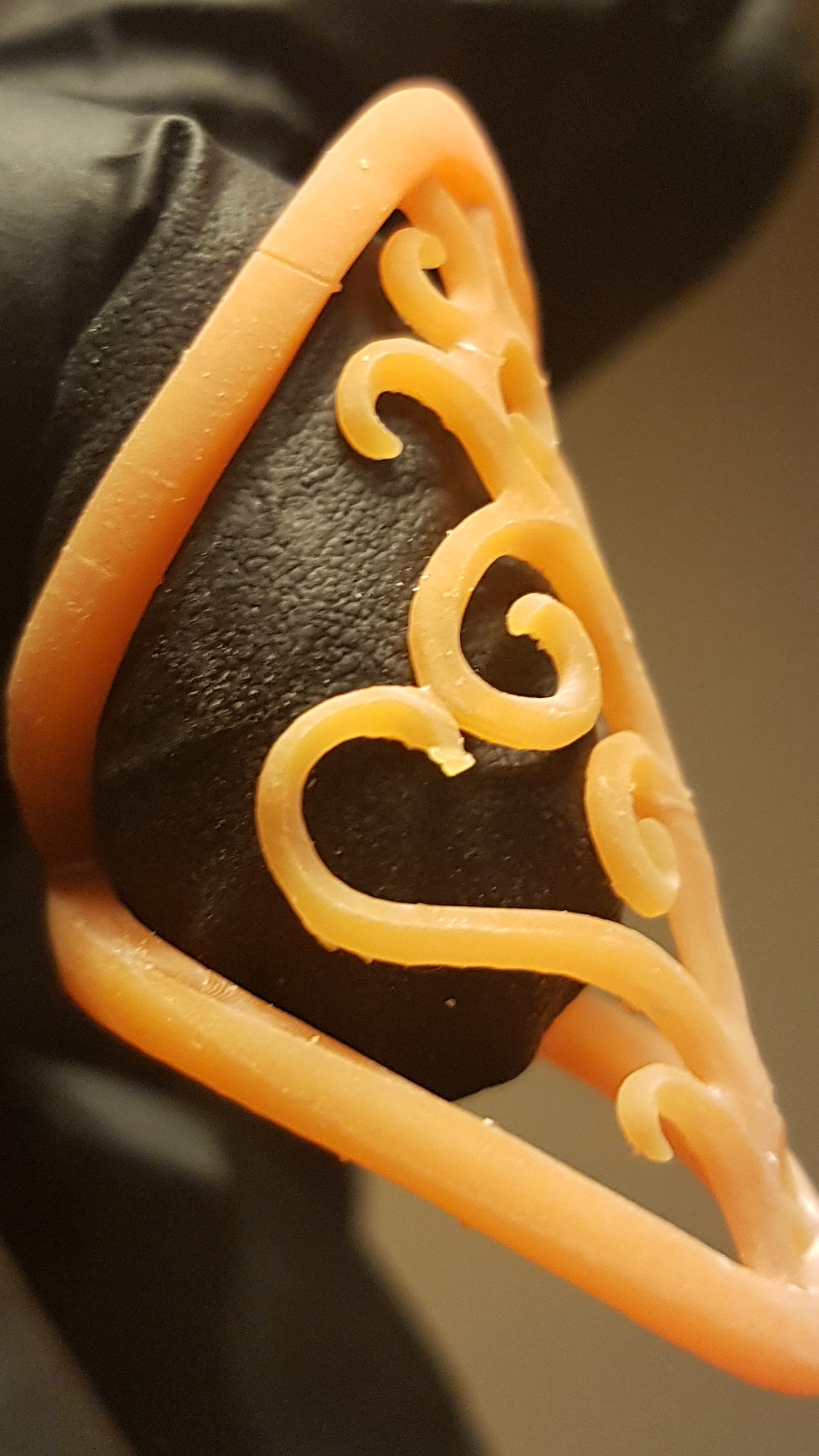

I have horizontal lines in my print that appear as grooves then the slice above (or same slice?) is off center causing a ledge. I did a lot of searching but I couldn't find much, some about flexvat tension but that was before the acrylic plate was part of it so I don't know if it's valid anymore.
Only happened twice in this print but it was enough to notice and likely ruin one of my more detailed prints:

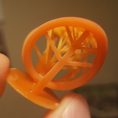

It's all working as it should be now, I did a few things at once but I'm sure adding horizontal(ish) support was what sorted it, tilting in 2 angles helped too. It was as you said, and the ring was splaying apart at a few points when going down to the flexvat. I just made them in 3ds max, it seems complex but it wasn't too bad to remove:
And the finished ring, no errors:
