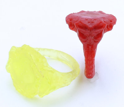

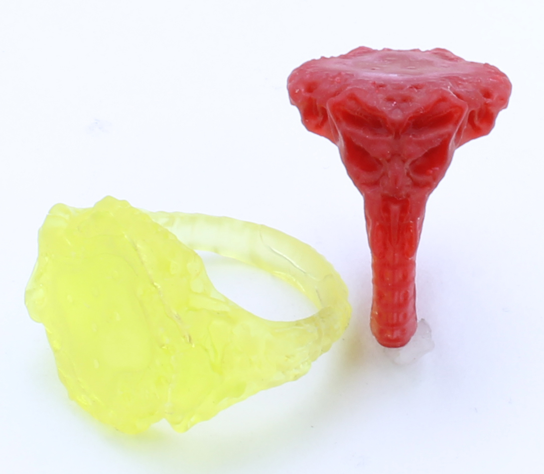

Yes I have, the listed times on the Castsolid site however did not work for me. This is what did.
Slice Thickness - 0.25
Exposure Time per Layer - 1500
Bottom Layers Exposure Time - 3500 # Layers - 5
Lift and Sequence Time - 3900
Z lift distance - 4
Z lift speed - 200
Z lift retract speed - 100

Its pretty hard to see the CastSolid print here. The ring was designed in Zbrush, the MS Red was printed at 0.50 mm and looks amazing, the CastSolid yellow was printed at a amazing 0.25 mm. I am really quite impressed with the quality of the prints and relative ease of use.
