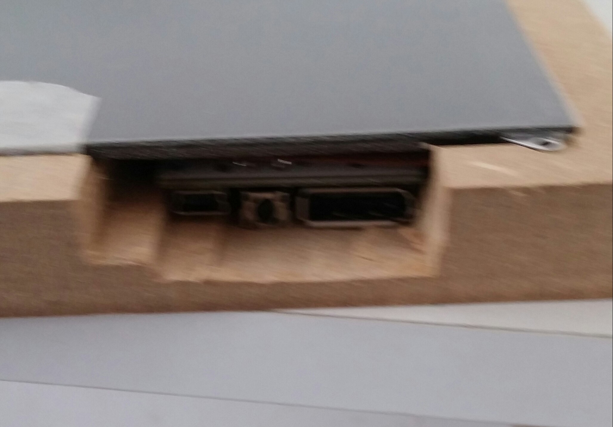

Still waiting on a new screen. Made a plate to hold the screen. I already had a vat larger than the screen. Plan is to use magnets to hold screen to bottom of vat.

Still won't let me upload pictures...
The magnets are on the outside of the screen holder so I don't think there should be an issues. Also as far as I know lcds aren't effected by magnets. Think ipad smart covers.
Sorry for bad pictures...
http://imgbox.com/J1nDM4wa
http://imgbox.com/o3JklLza
http://imgbox.com/zl9fh3eO
