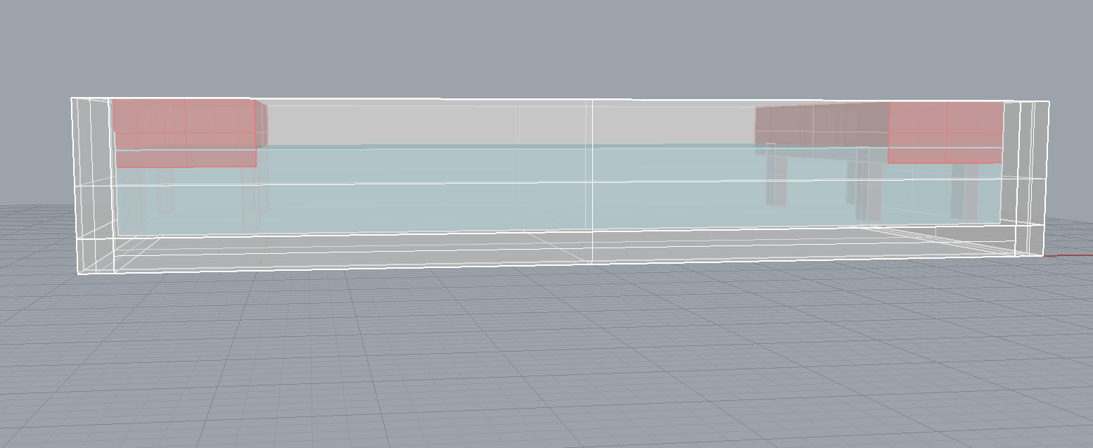

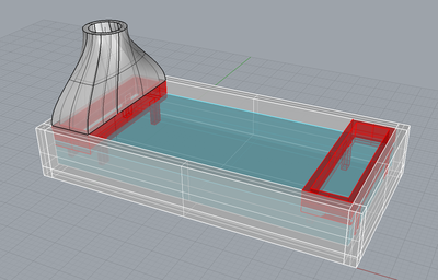

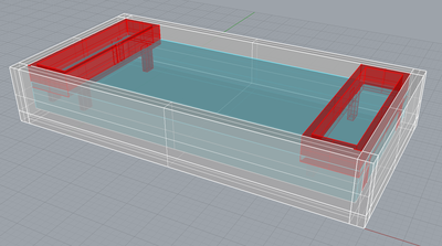

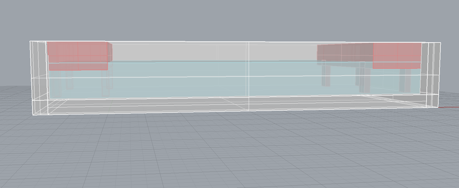

I'm currently using PDMS with a B9 similar setup. PDMS will not streech to an acceptable point. When I replace old PDMS coating I usually streech it to the break point and it breaks very easy. Maybe if casted with modified proportions the result will be different.
The guy in this video is using PDMS over Glass. And it works. Thinking on how to maintain PDMS over glass (for rigidity) oxygenated, it can be casted with two openings on the sides, allowing oxygen to penetrate into PDMS. The problem is that this penetration will occur only on the sides, and not at the entire surface. Attaching an air compresed source to this openings may solve the problem, but looks like overengineered. I attach some pictures. White is glass/acrilic vat, blue is PDMS and red is the openings.

Would oxygen migrate all the way to the center of the vat from the openings on the sides ?

don't want to sound negative but i would think oxygen would migrate at best a few microns into the PDMS,
or if it does migrate more, it would do so very slowly and the oxygen needed in the dead zone would not be replenished fast enough.
I think.
