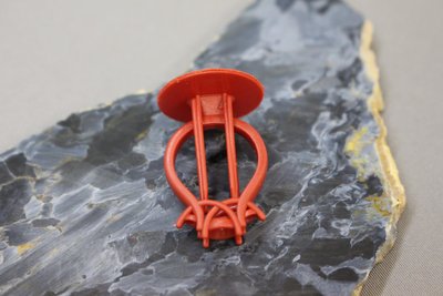

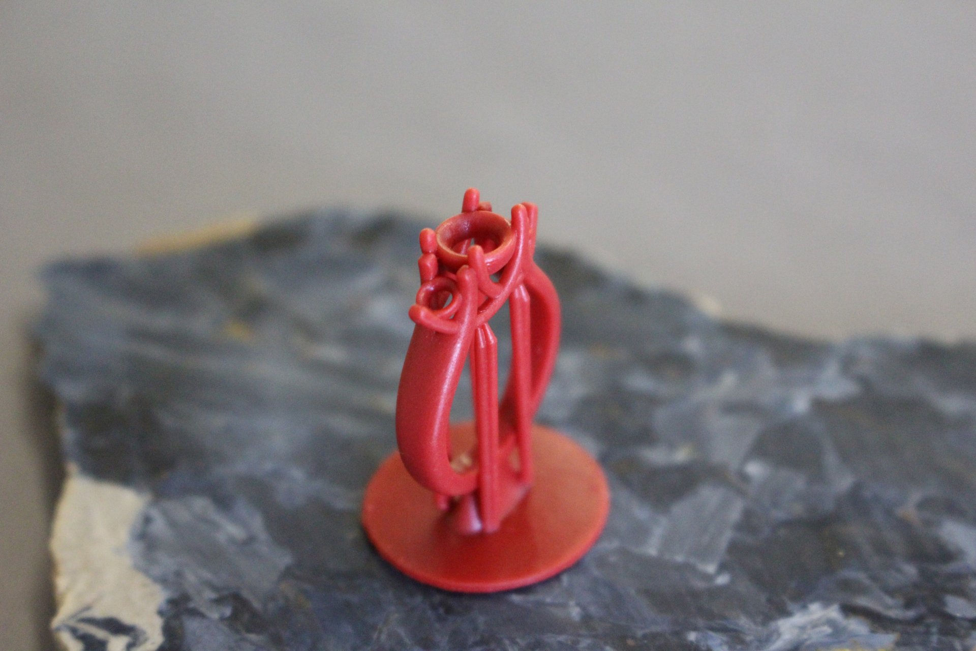

Print in B9 Cherry:
- Projector settings: Eco mode, 50% Brightness, 60% contrast, 1.8 Gamma
- Exposure settings:
- Slice Thickness: 0.025
- Exposure time 2500 (ms)
- 1 Bottom layer at 10000 (ms)
- Lift & Sequence time 6000 (ms)
- Z Lift 4mm
- Z Lift speed 120
- Z Retract 250
- Slide Tilt 3
- Print time: 2 hours 48 mins
- Model Height including support and long prongs 29.62mm
