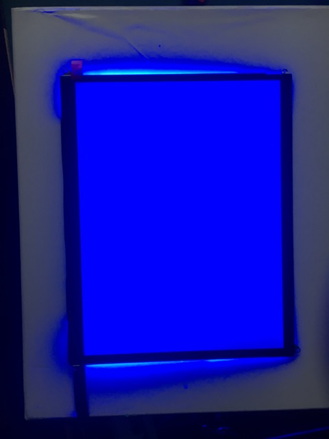

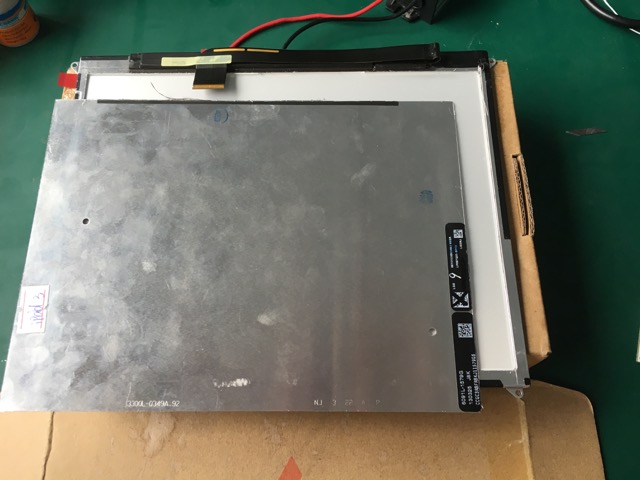

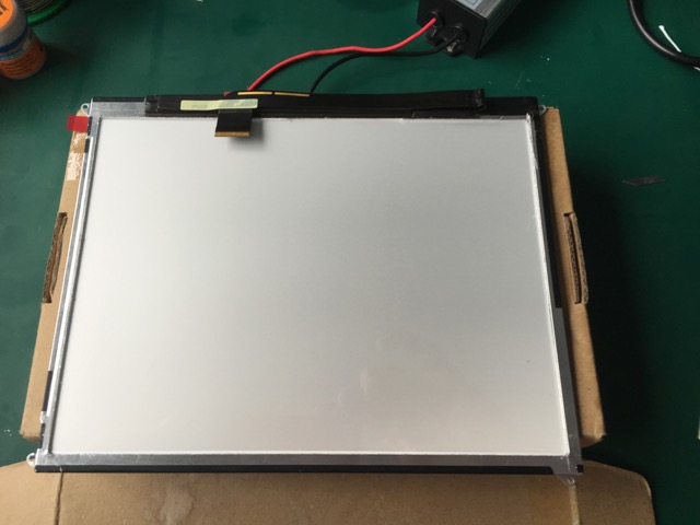

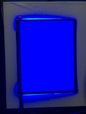

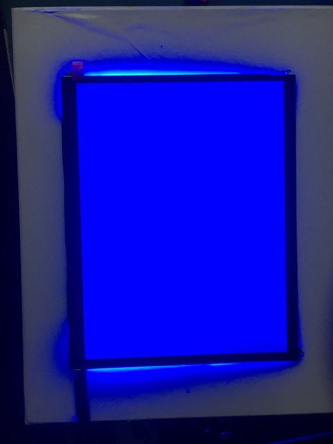

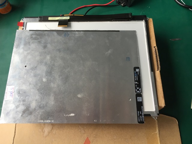

After thinking a little more about the display teardown , i decided to find a solution to keep the original backlight functional so i could use it to display red calibration grids or simulate printing ( with red color ) without firing the 50W LED array ...
so I decided to cut the metal backing of the display ... ( yes i'm crazy .. .) ,
here's the result:
here's the result:

Very cool and good idea! Looks bright and evenly lit.
Patiently waiting to hear what your cure times are like...
