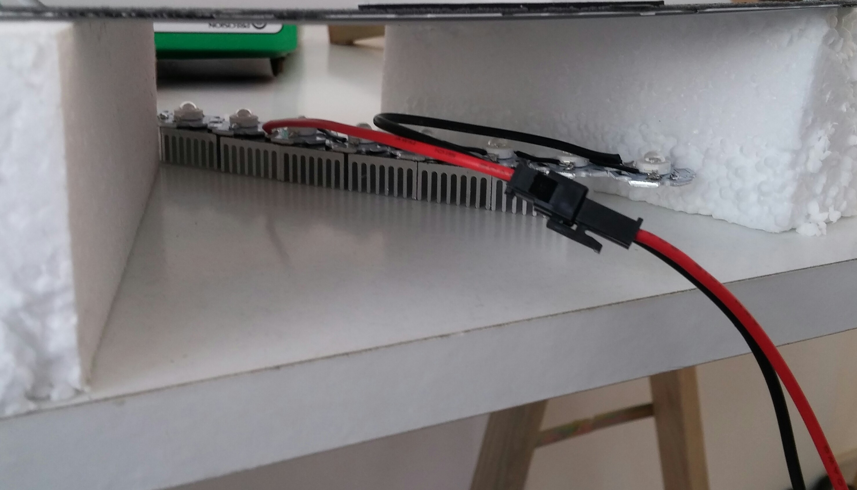

Ran some 3w 470nm blue leds through the ipad screen with what I think were the 3 filters closest to the screen to even the blue light out. When the screen was 35-40mm from the leds it seemed pretty even. Only had 6 leds wired up.
