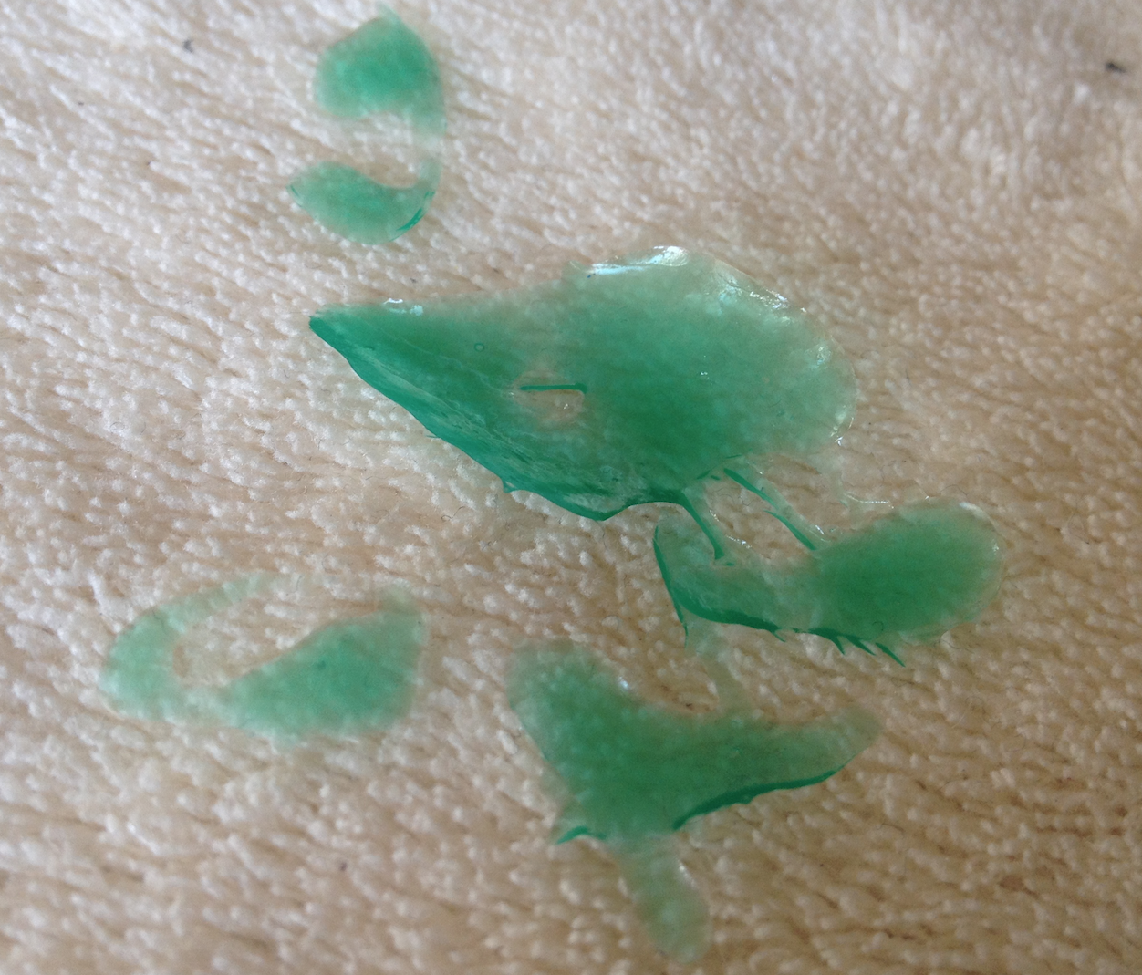

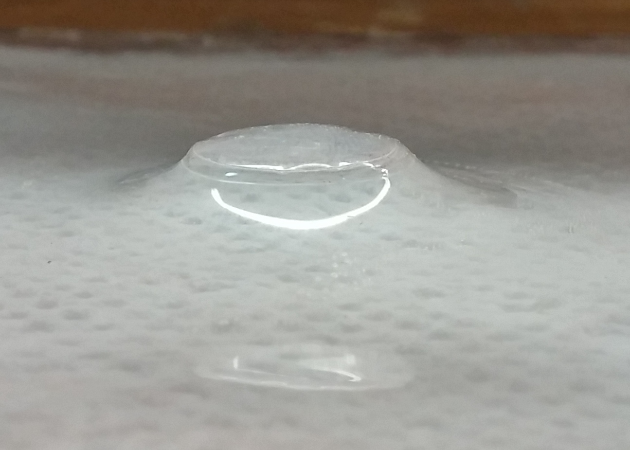

Re: Flex bottom VAT /OVEN BAGS
Postby SIDRANA » Wed Oct 22, 2014 12:01 pm
The Turkey Oven Bags
SIDRANA
Posts: 128
Joined: Wed Jan 22, 2014 1:31 am
Location: LOS ANGELES
Re: Flex bottom VAT/ THE BAGS
Postby SIDRANA » Wed Oct 22, 2014 12:26 pm
Comes off like a butter

SIDRANA wrote:Comes off like a butter
Nice! After a little online research, the non-stick oven-roasting bags are coated with PTFE.

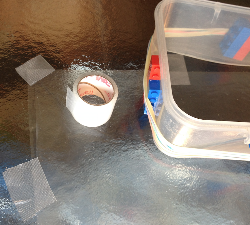

Postby SIDRANA » Wed Oct 22, 2014 4:49 pm
Hello
Actually the resin is; directly from the bottle to test the film; As of now I am making the FLEX-VAT from a container,
and going to foil the bottom part corners away, rather than cutting it to have a clean surface .
