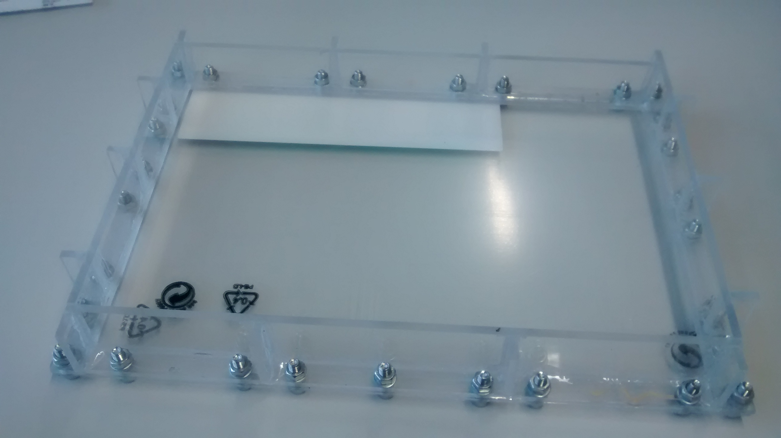

I've created a VAT out of 6mm acryl and a 2mm acryl bottom which is removeable: plan to test a FEP film instead of my silicone -> hope int improves my prints.
On the picture there are still the protective films on the 2mm bottom.
Print area is 240 * 135 mm :twisted:
