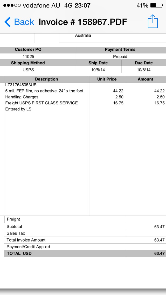

Yeah direct from cs Hyde just checked out with a credit card
I got the 0.005in thick 24inch by a foot size
No adhesive which in hind sight was a mistake I think,

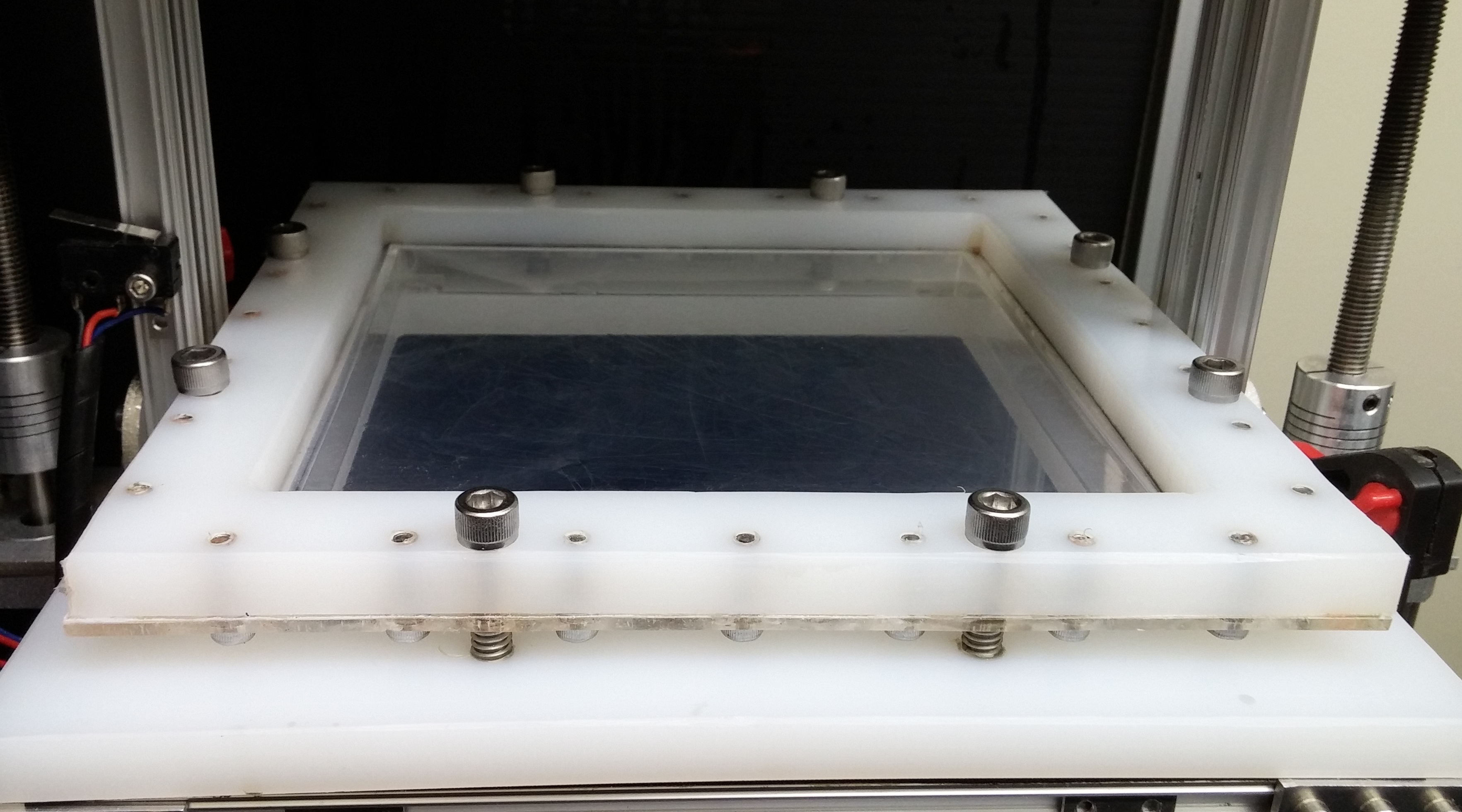

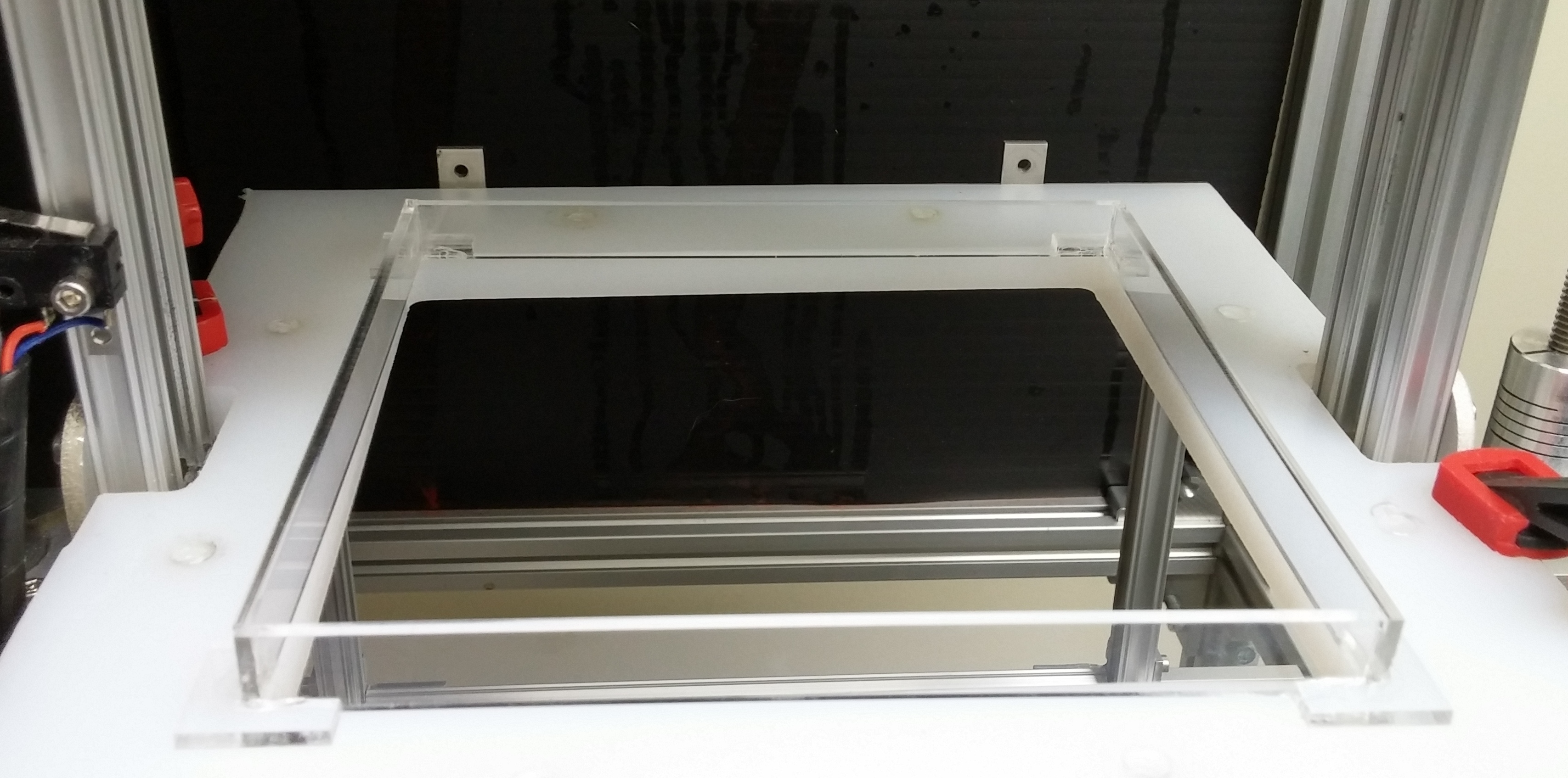

Here is my version on a mUVe DLP. It is a work in progress so don't look to close. The first pic is the lower portion showing the acrylic tension walls. The second is the complete assembly with the 0.005" FEP pulled down taught. I think a tension system is a must. I'm still playing with exposures as they are too high at the moment (16s). I removed a PC sheet I was using for protection but that didn't seem to help much. I have to look at my projector settings next. Once I have the exposure set correctly I have had no issue with sticking to the FEP. This FEP sheet has seen about 25 parts and has a few scratches from poor cleaning procedures.

16sec on exposure time seems a bit hight iv only done one failed print (due to crappy vat) but it seemed to be good around 3s

My Vat ist now also working. I have Stresstest it and Print a lot of Objects on the same film with out of negativ results.
