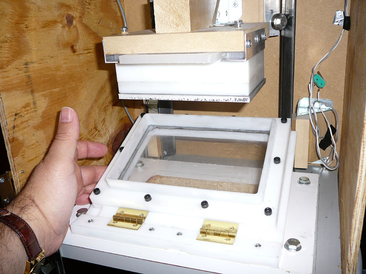

I have built what I am calling a passive tilt. It's really very simple. The tray is hinged on one side and free on the other. The vat floor is glass with PDMS (Sylgard) coating. As the z axis is lifted the free end is lifted causing the tray to tilt. when the suction is broken it falls back to level. With this setup I only need 1 axis (Z) of movement. The first few layers the tray lifts about 3/16" due to the surface area of the build platform. later layers with small cross sections barely lift it at all. For now I'm lifting about 1/4 inch for the 1st 5 layers and about 1/8th for the remaining ones. Sometimes even that is more than necessary. If I could determine the area of a layer I could modulate the z lift accordingly and shave some time off the print run.

Do you think that there is any need for a shock absorber or anything to control the rate that the vat returns? Is there a stop that limits the vat travel? I too am glad to see someone try this as I am a fan of simplicity. Have you made any attempts without the Sylgard? Keep us posted. This could also provide an opportunity to shorten the cycle if there was a limit switch that indicated that the vat was down. It might be a pain from the software side but could take hours off of print times.

@ sitzme, I don't have anything to slow the vat return. On most layers it is only droping maybe 1/16th of an inch. The viscosity of the resin has a big effect on how fast it falls. I guess I could put a felt pad or some other cusion so it doesnt "thud" each time. As for limiting the upward movement, Since it is anchored on one side it realy cant pull up to far without separating. I left it free so I could tilt it up to make it easier to drain and clean the vat between prints. I like the idea of sensing when the tray has dropped to speed up the cycle. The only problem is that when the exposure area is really small, the tray doesn't seem to lift at all. I think a better plan would be to calculate the z lift distance based on the exposure area then you could lift the z only enough to break the suction and return for the next exposure.

If you think about it:
Pulling one edge down like the traditional motorized tilt is mechanicaly no different then holding one edge and lifting the platform up. The forces exerted on the cured layer are the same.
The difference is fewer moving parts. Just some home hinges vs hinges, a mechanical linkage, stepper and driver.

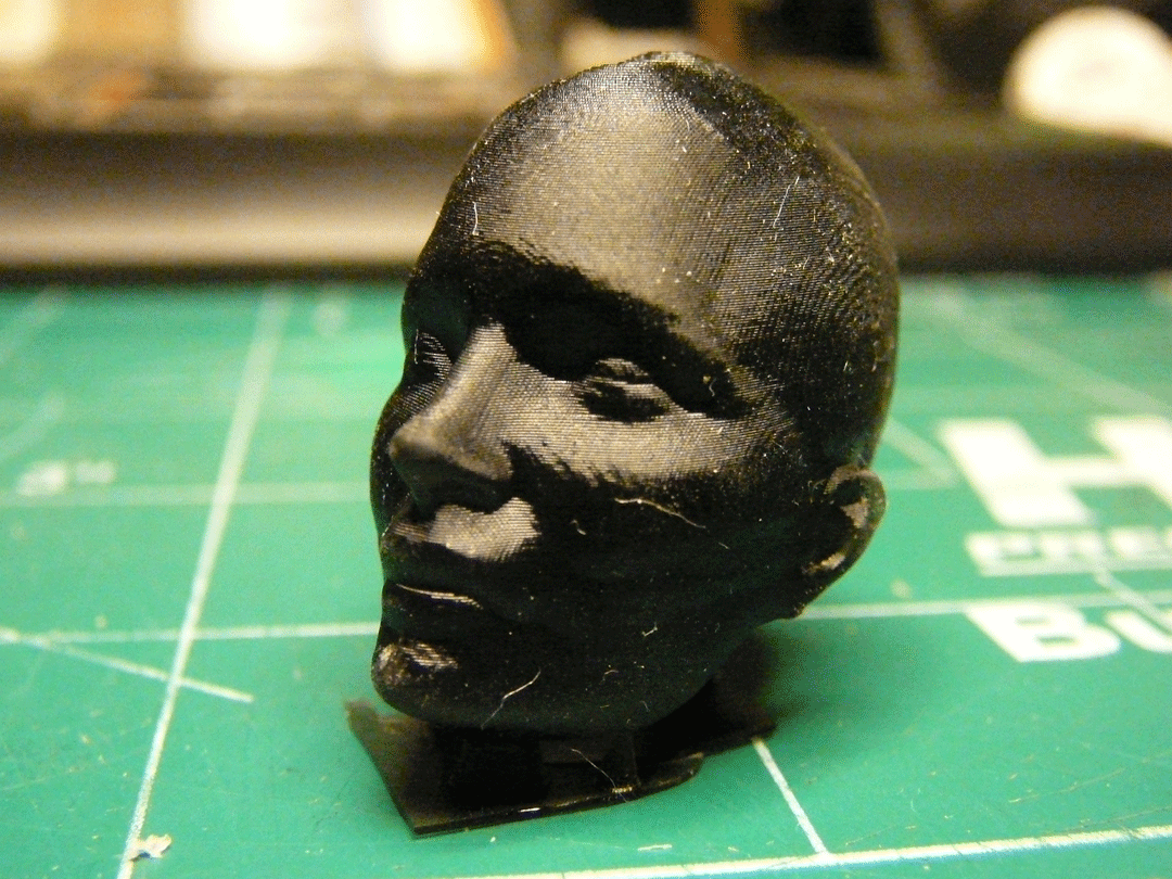

I'm still tweaking the resin/exposure to get the best detail but you can see the passive tray tilting is working fine
