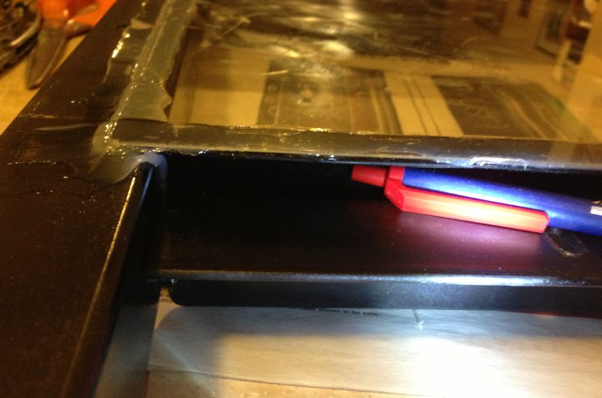

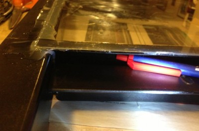

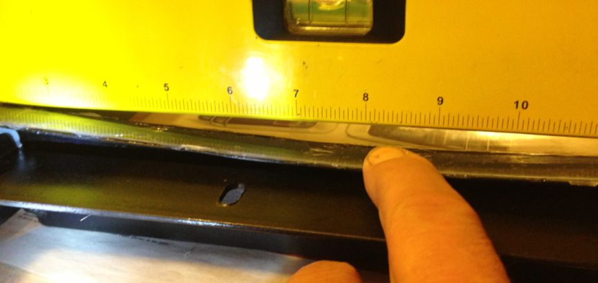

The vat that I am building has a 12" x 12" x .031" piece of Gorilla Glass as the floor of the vat.  It is attached to the frame on 2 sides using silicone.  The other 2 sides are free to flex up to .5" .  An "L" section of silicone material provides a flexible end wall to the vat and allows flex in one direction.  A piece of .12" thick glass is mounted under the Gorilla Glass for support.  When the build plate lifts, the Gorilla Glass will be able to lift off the glass support, flex, and peal away from the cured resin.  I did one test before starting construction.  It was similar to the tests above, only a much larger area.  I did not take a careful measurement, but estimate that it was a 6" x 3.5" oval compared to the previous tests where the resin was no larger than a 2" diameter circle.  Lifting the Gorilla Glass by two edges, it flexed and pealed off easily.  No coating was used, just bare glass.  The advantage that I see if this works is that the glass will remain free of wrinkles, tears, and UV damage.  It is also as clear as, well, glass... ;^)  It will be interesting to see if there are issues with refraction.

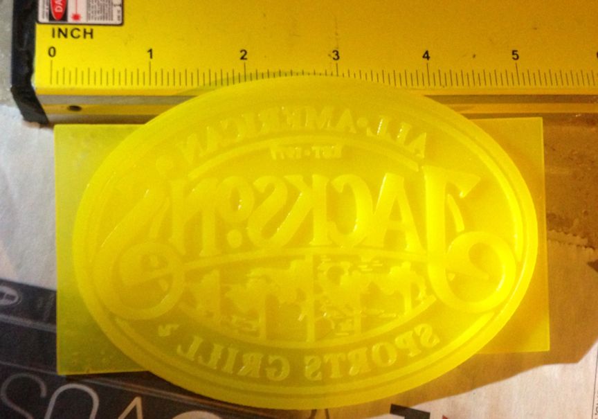

I did two prints using a glass build plate since I didn't have time to fab another aluminum one.  Both prints released from the build plate before finishing but the first one was almost done and turned out OK for a test.  The print is 5.12" x 3.5" x .12".  The print released from the vat fairly well at the beginning of the prints and seemed to be bonded more later in the print.  The first 15 layers are solid and then the relief image is the last 15.  The part has warped about .09" in 3 hours.  On the first print the lift was 6mm and it was not enough to get consistant release without a little manual pressure on the vat glass.  On the second print, the lift was 12mm and it was releasing from the vat on its own but popped off the build plate a bit more than half way through.  The resin is MakerJuice SubG+ yellow, original pigment.

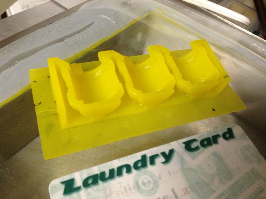

I had a successful print tonight if you don't count snapping it in half while taking it off the build plate.  A little UV laser and it was good as new.  I had been having trouble with prints not staying attached to the build plate and then realized that I had switched resin to SubG which has a shrinkage of about 9%.  SubG+ was used for this print and it has shrinkage closer to 3%.  It was a little over exposed but turned out OK.
The print was made directly on the Gorilla Glass with no coatings.
The long side of the print was oriented 5 degrees off of the Y axis to help with pealing. The lift move was Z2F20,Z4F30,Z2F100 and then down at F200. There was a little popping/crackling noise but not very loud. Previously the lifts had been a little faster and that may have caused some of the premature release from the build plate. I had tried one using supports in SubG resin and it failed. This time with SubG+ I added a brim and printed directly on the build plate.
This is a promising start and I will be working with progressively larger prints. The build plate is 10.5" square and I am printing at 1 pixel = .01" at this time.
