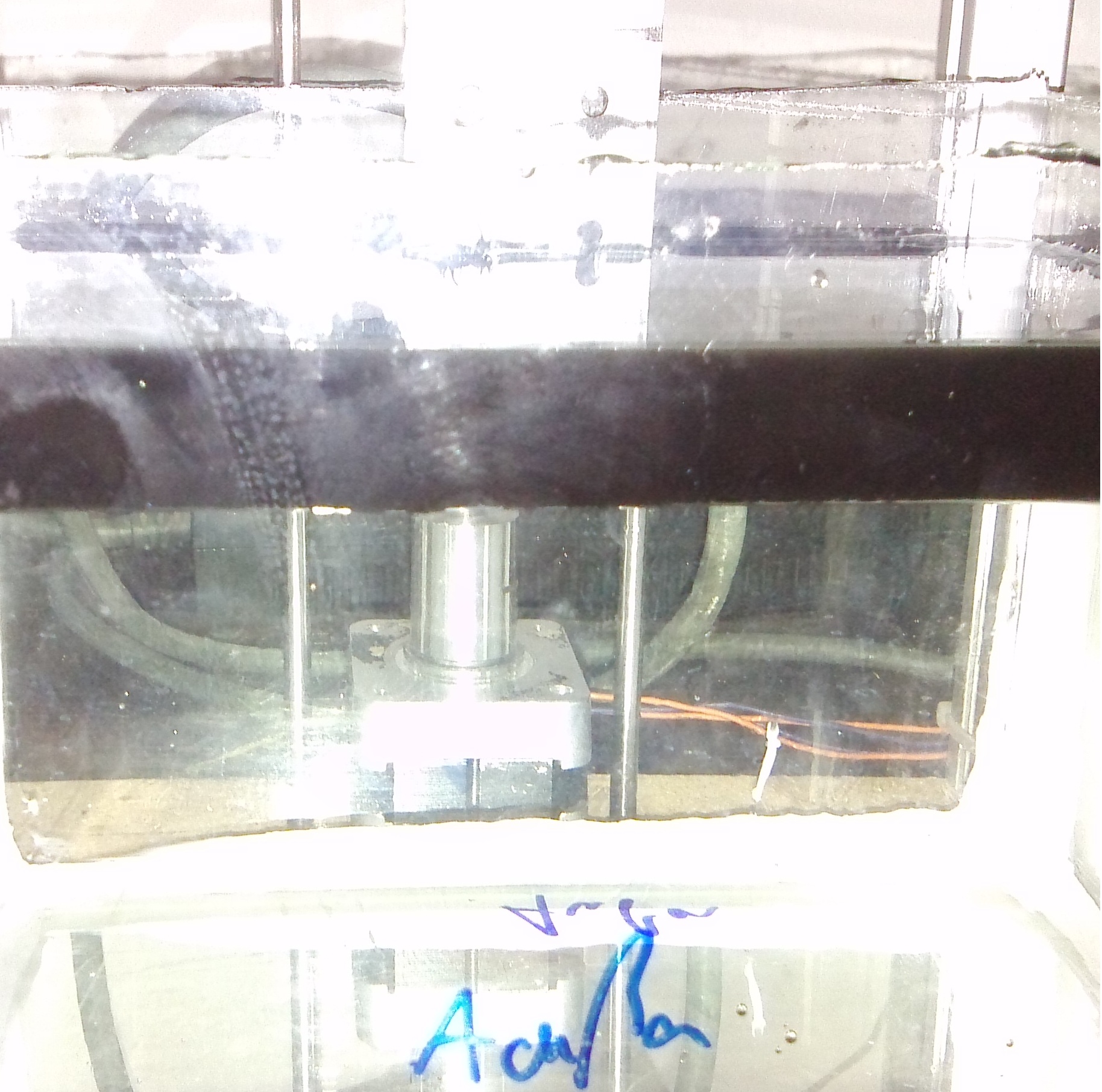

Hey,
i've tested a little bit and now i've got a solution for resin floating.
The resin and the solution stays stable for 3 weeks now and there are any reactions.
I've got no problems until now and i was able to save nearly 150$ for resin.
If there is somebody interested in getting this stuff, write me message.

how does the water affect the stability of the resin while printing? I would imagine the resin sloshes around more on top of the water? like if you were to bump the table in the middle of printing a layer would it affect the layer thickness due to the resin moving from waves or ripples in the water?
