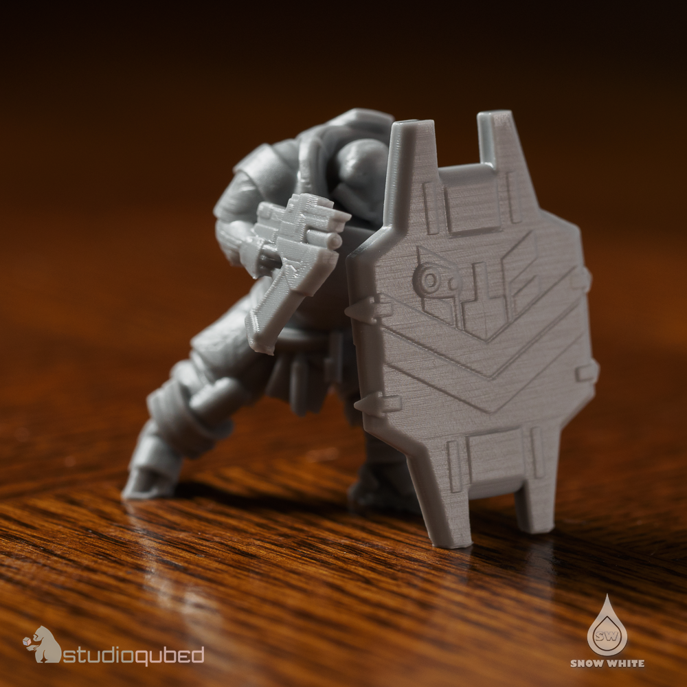

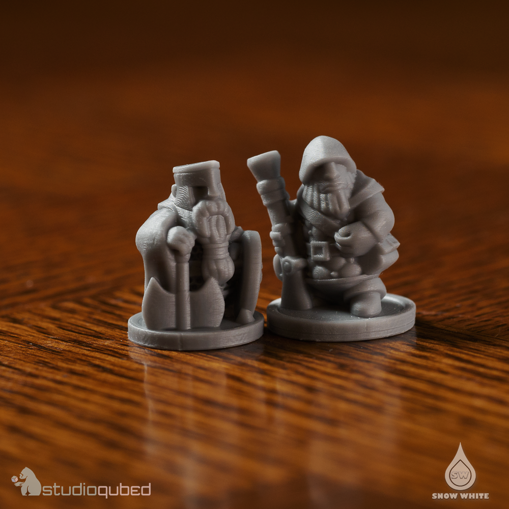

Re: Best resin for miniatures
Hi everyone, here are a few pictures for you. The new Fun To Do Snowhite - more news will be announced this week! Its perfect for minatures
@minimaker: Sorry for not getting any photos up, I've been super busy lately, and Craig's prints are much higher quality than what I've been able to achieve anyway.
@Craig: Wow! Those look so good. What resolution are those at?
@minimaker and @mcguinnessdr
I missed the your replies, those prints were run at 50um xy and 38um z using the new Snow White resin. Both of the new blends are available for order now, web site indicates pre-order but stock should be arriving early next week. Feel free to pm or email with any questions.
