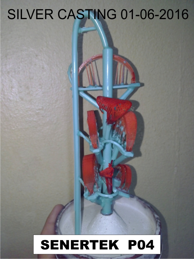

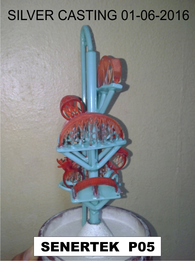

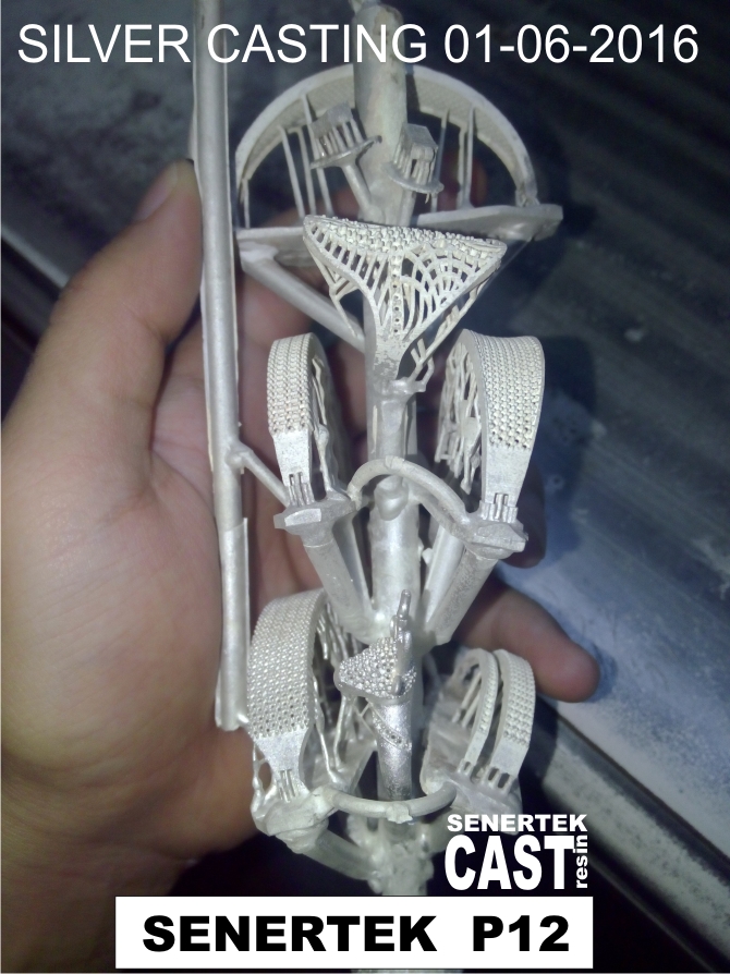

silver casting photos from customer.
http://senertek.com/3d/tumbo.htm

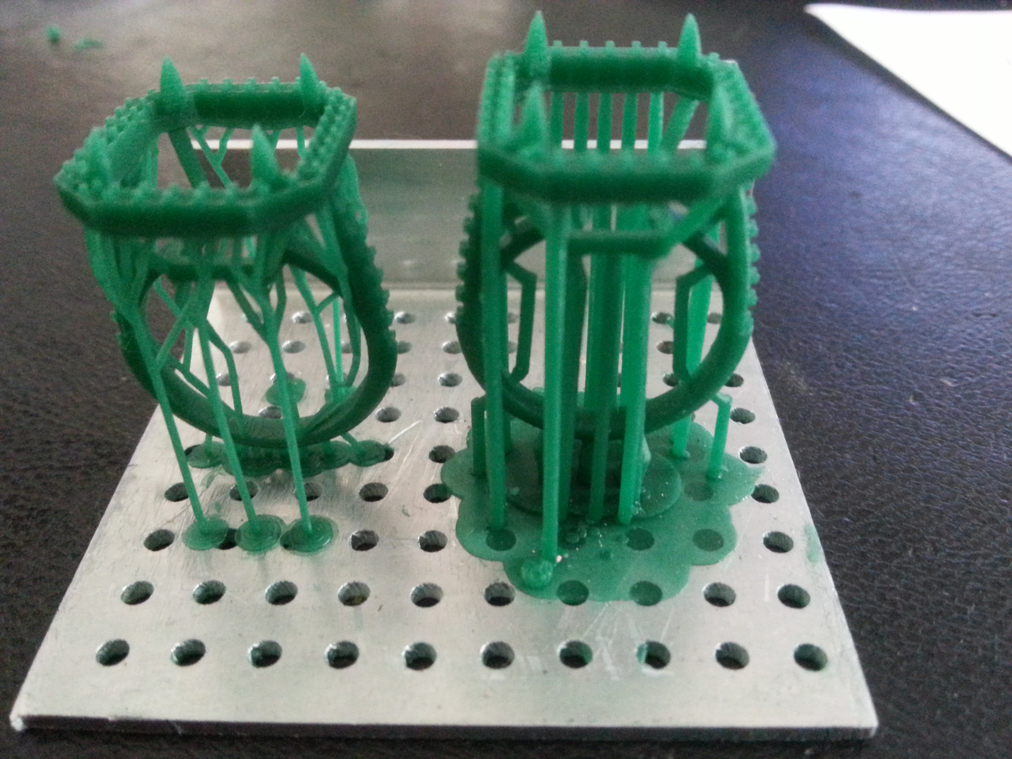

Been trying with B9 Yellow which keeps sticking to the damn VAT FEP! I'm wasting FEP as a square test piece I'm printing keeps getting stuck fast. Picking it off just destroys the FEP! :evil:
So far not happy with that resin but will keep trying as I have a litre of the stuff!
Tried slowing down the Z speed which wasn't working. That could have been due to the damaged FEP as no tension to release the print. Grrrrr.
Can someone please advise as to how to sync speed of Z and beamer. Since slowing it down, the beamer exposes the next slice before Z reaches down.
Using a LittleRP!

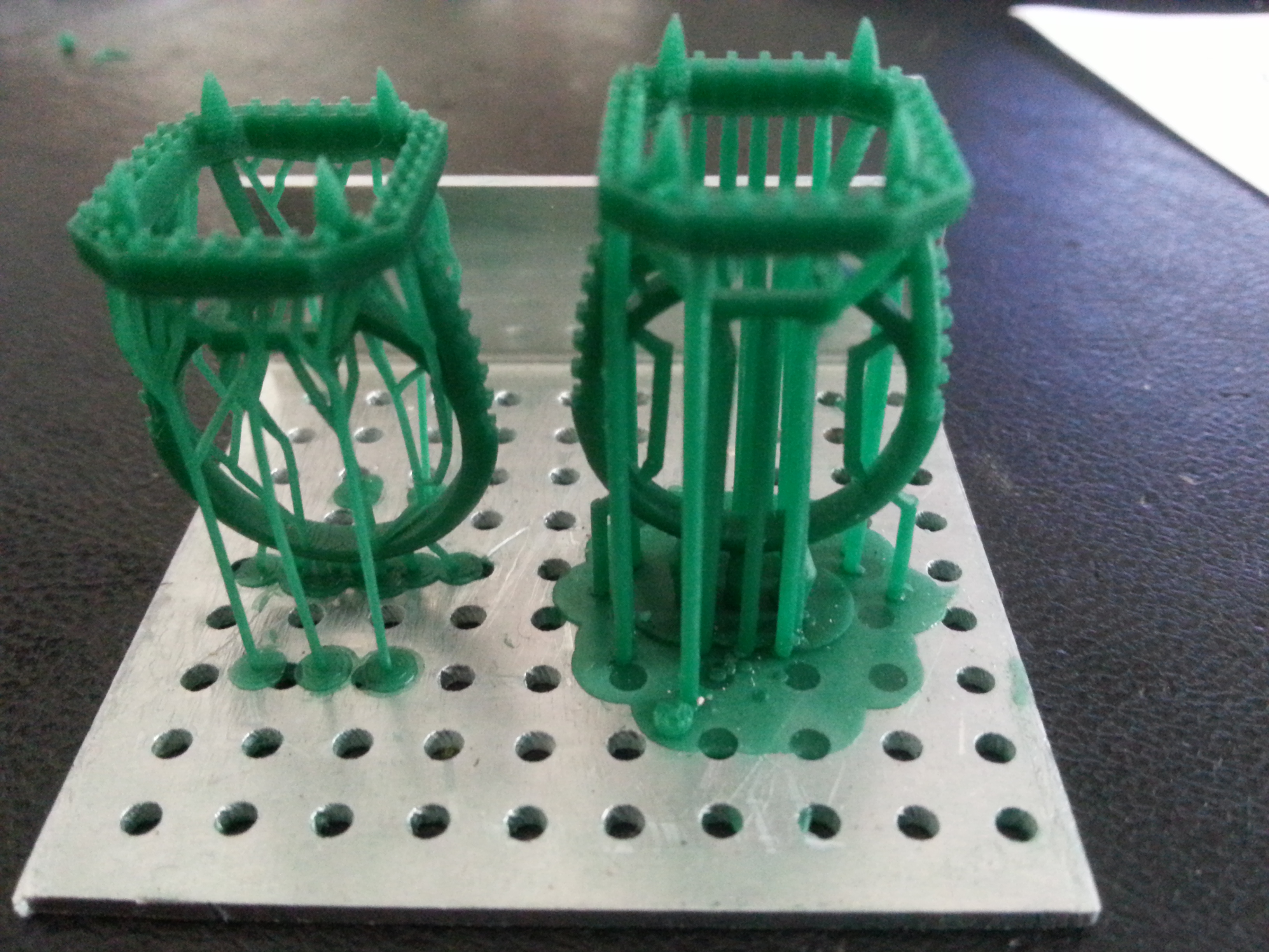

Re: Resins For Investment Casting
Postby chill74 » Tue May 17, 2016 1:29 pm
WaxCast seems to be casting very well. I am still adjusting coming from the B9 resins insofar as temps and curing. However, following the Waxcast docs for casting gives a very good baseline so far.
Postby chill74 » Wed May 18, 2016 7:04 pm

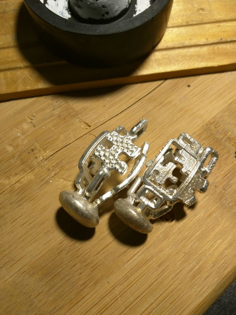

Yeah, those are layers printer horizontally at 50micron Z so there might be some banding on the closeup.
I will probably drop down to 25-30 micron.
chill74
Posts: 20
Joined: Tue Jun 16, 2015 3:09 am
Postby chill74 » Tue May 24, 2016 6:57 pm
Just thought I would add to my previous findings about Waxcast. The lines in the casting are from overcuring the waxcast resin. Apparently it is more sensitive than some of the other casting resins. I dropped my exposure time from 9sec at 50micron to 3.5sec at 50 microns and the prints are smoother.
svs
Posts: 48
Joined: Thu Aug 28, 2014 1:15 am
Postby svs » Thu Jun 02, 2016 12:44 am

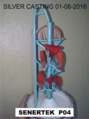

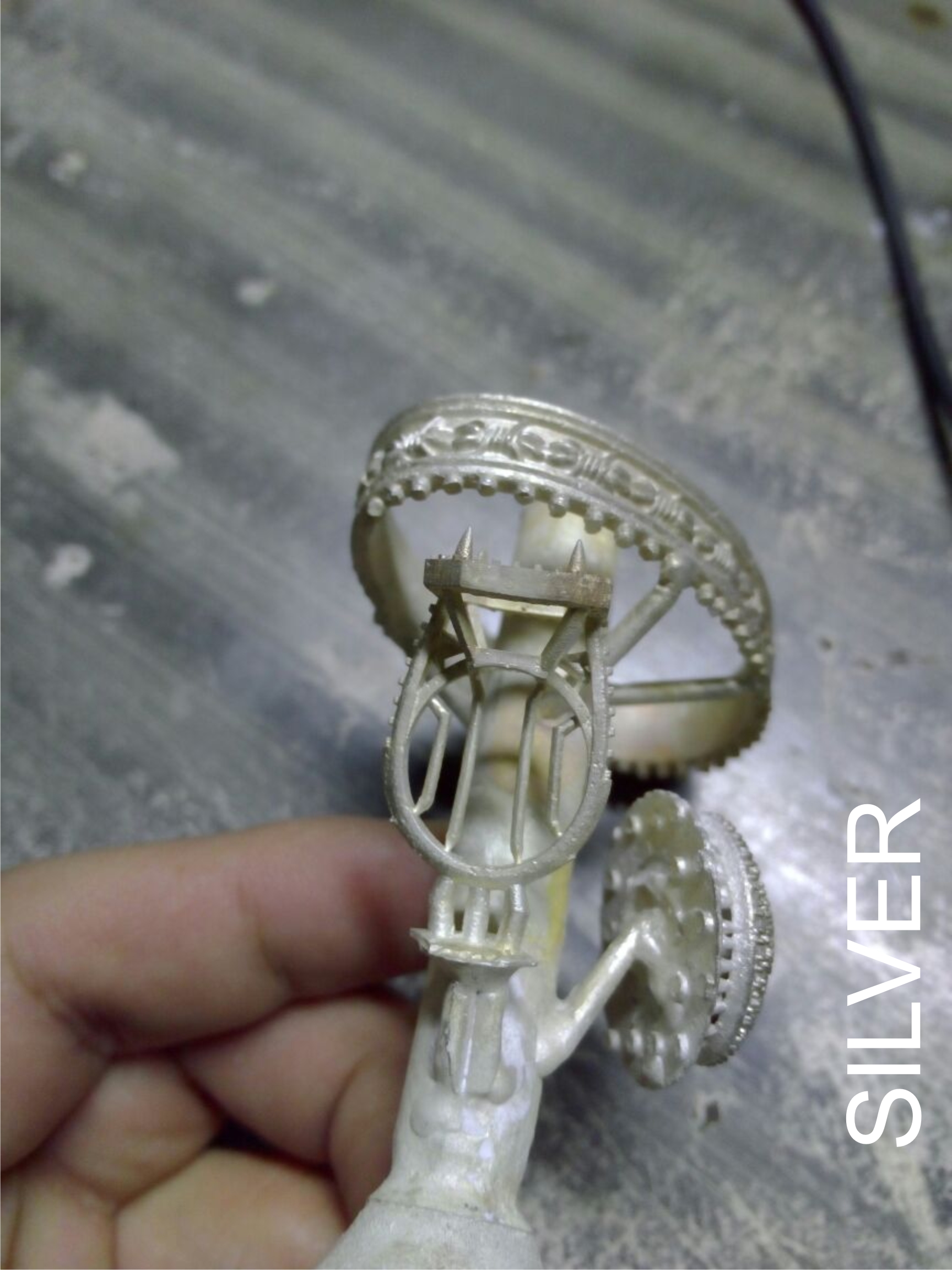

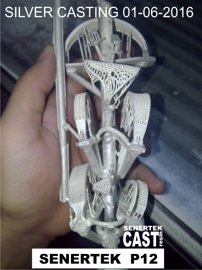

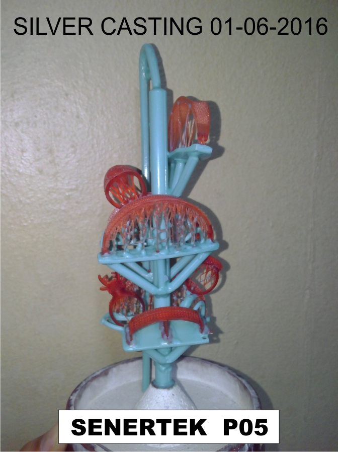

Silver castings from customer ODABAS JEWELLERY izmir /TURKEY
