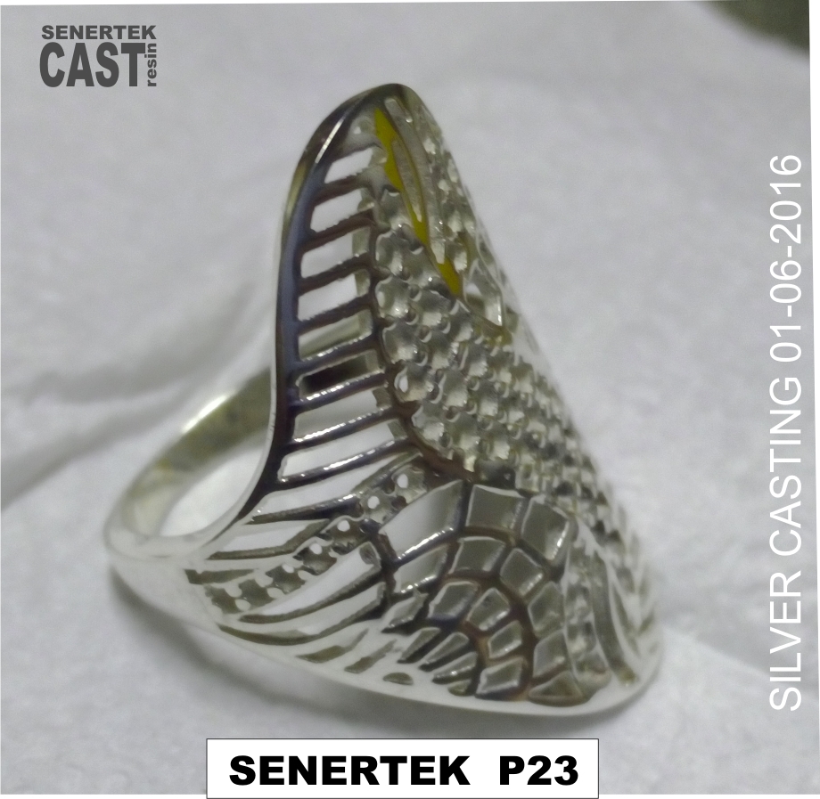

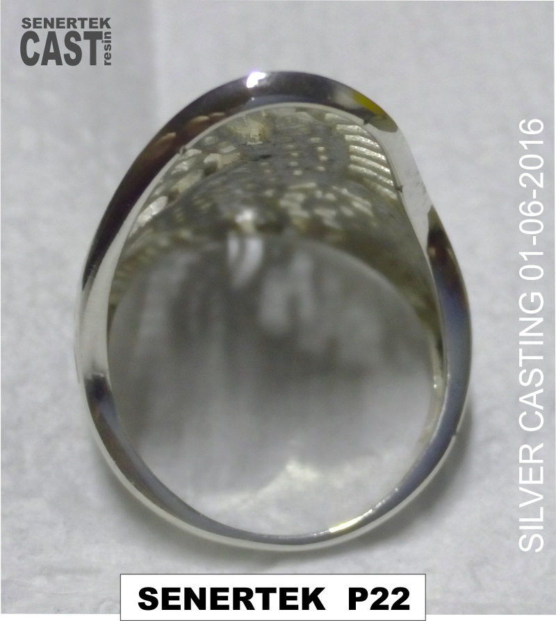

Silver castings from customer ODABAS JEWELLERY izmir /TURKEY

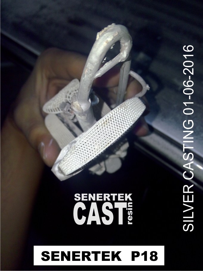

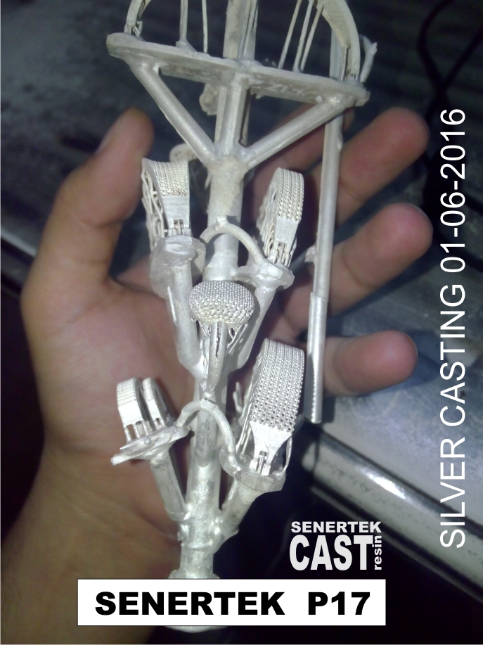

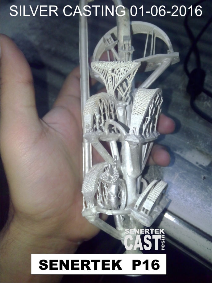

Postby svs » Thu Jun 02, 2016 12:47 am

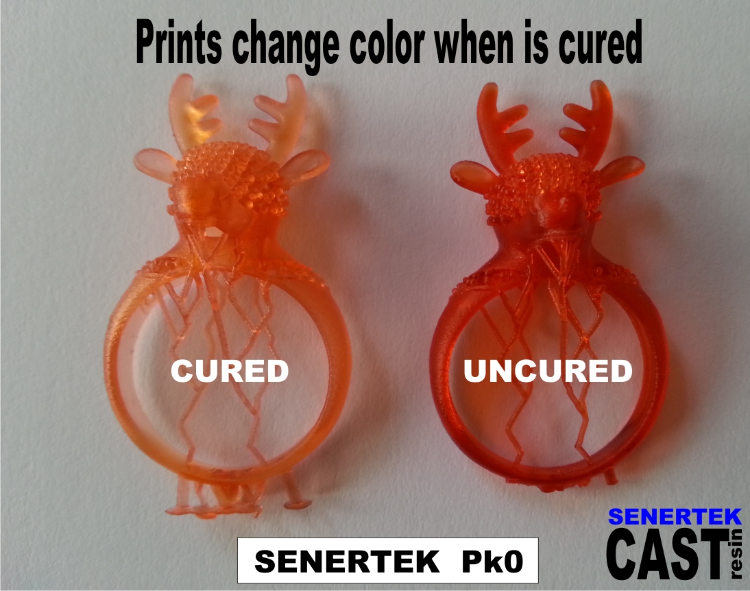

snr CAST resin is changing color when cured !!!....You can understand your prints cured well or not ...

The WaxCast casts exactly like wax with no ash and a smooth surface. However...it MUST be cured all the way...meaning it has to be almost yellow. I can post some castings in a few days. I hade some rough surface castings initially when I did not let the resin cure (it was still too orange..and it reacts with investment giving a very rough texture) ...had the same issues with the B9 Cherry/Red when it is not cured...
B9 has a light they sell that will fully cure their resin and I am told WaxCast as well. There are other means of DIY coating that will seal pretty much any castable resin eliminating the need for curing.
