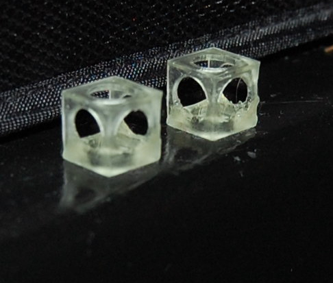

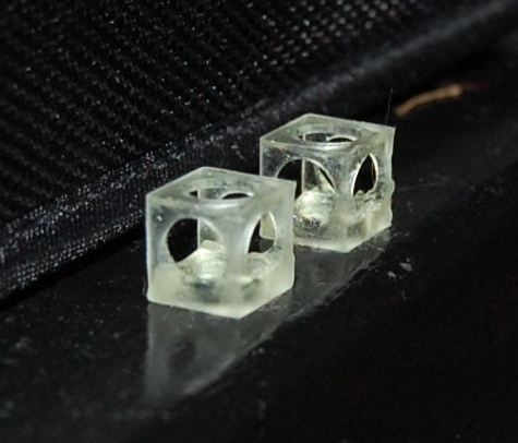

I have had a problem with my freshly developed Sla printer. Everything seems to be normal half way through the print and then it won't handle the the remaining half. The printer is simple, only a moving z axis with no tilt or slide option for the VAT.
You can see that the first half of the hole/circe on the cube(10x10x10mm) is fine, then it starts to become a mess.

I get the feeling that the resin cures to thick at the end and the only reason it doesn't show before the second half is because each layer becomes increasingly larger at that point and allows the uv light to cure resin through a level it isn't supposed to.

I agree with your assumption. I would think that there is stray light coming from the projector in between exposures. A way to prove this would be to stop the print just before the halfway mark and then empty out the build tray and then replace with fresh resin and continue the printing. If it then prints the rest of the print without issue then it's most likely the resin is getting overexposed gradually.
A mechanical shutter can be used to stop light from exposing the resin in between exposures. Also, look to see if light is escaping from the projector anywhere like through seems or air vents and such. One other thing you might consider too is some types of florescent shop lights can cure some types of resins. Sunlight too will cure all types of photocurable resins.

Great input James. But it turned out to be light scattering. I added some pigment and it solved pretty much everything.
