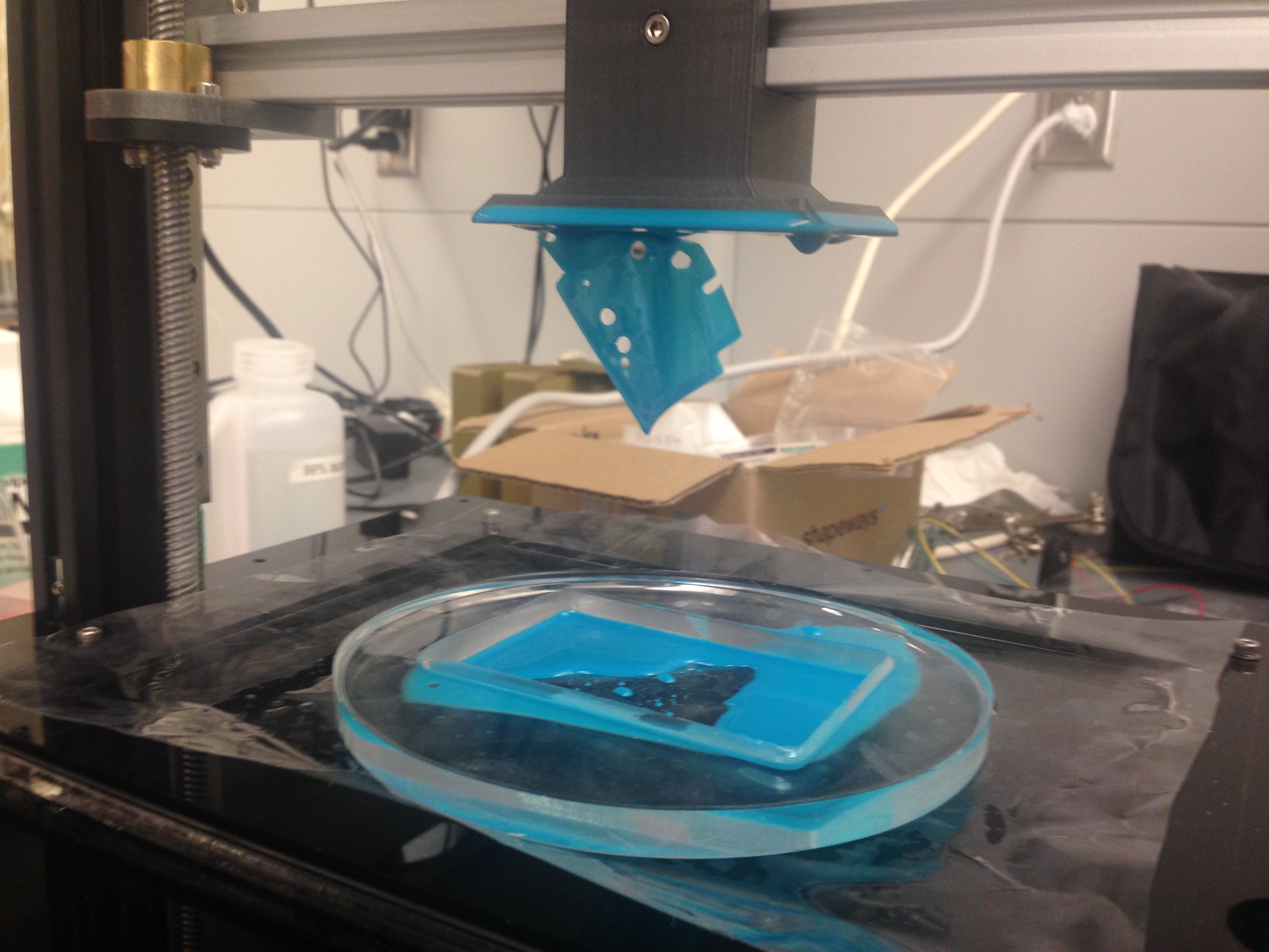

Postby AndersonTa » Sun Jan 18, 2015 12:25 am
So I haven't done much different than what I've described here in this thread, but I'm getting patterning and still testing.
Very close to full 3D print, but having some adhesion issues. I'm currently trying to work on implementing a diffuser in the mix to ensure no hotspots.
Some proofs to encourage you all to keep on working on this. I can see the potential!
It's 3Dish? :)
