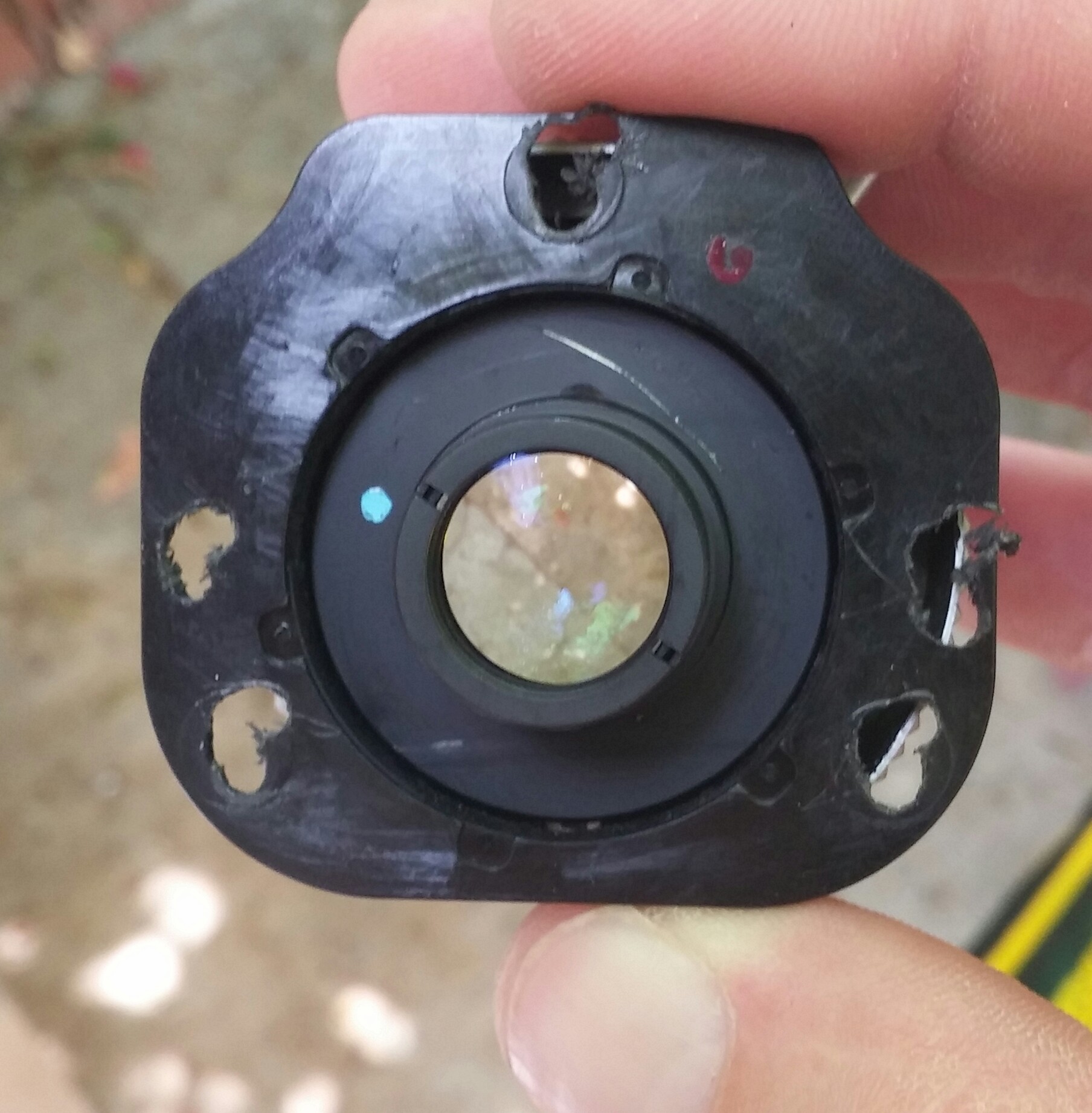

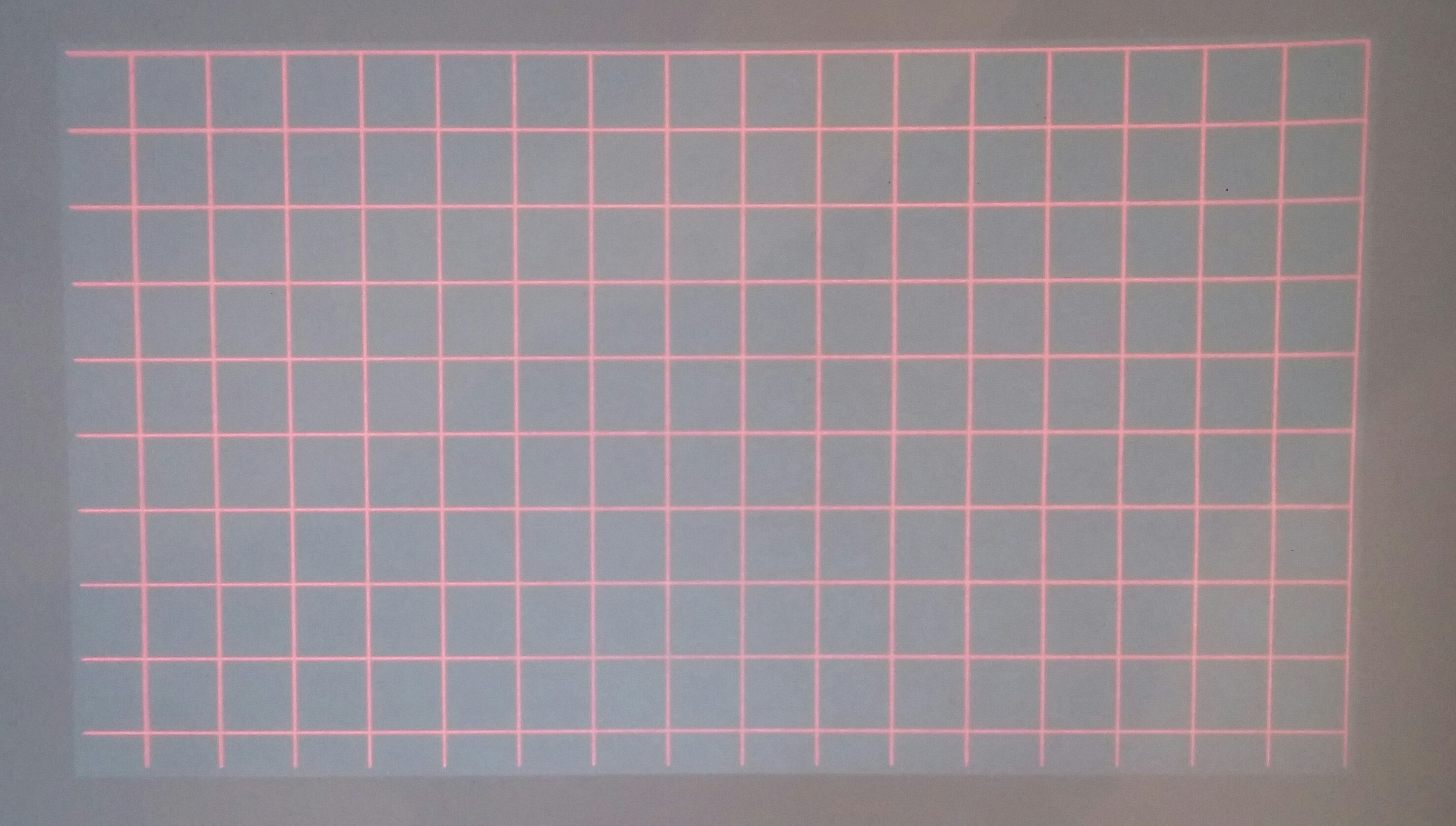

Went ahead and moved my lens down and definitely helped the overall focus. Now I need to do a sideways shift. The 2 outside rows on the right aren't perfectly in focus but everything else is.

I just moved my lens and that combined with adding a mask has me feeling like the whole area is usable.

So you start off by disassembling the printer by following the instructions at http://imgur.com/a/FOgXW a note on this is that to remove the first part that covers the bulb you side it sideways and don't just lift it straight out. Also the 6510 has an extra screw or two but otherwise identical.
After you have the lens assembly out it's just a matter of opening up the mounting holes. You want to move the lens AWAY from the side that isn't in focus. I moved mine down and to the left looking at the projector from the front. The picture is from the back of the lens assembly so the holes are opened up to the right. I used a 3mm drill bit which isn't the most precise method... A small file would be much cleaner....

Re: Acer H6510BD
holy crap, sharpness looks incredible, especially in the top part where it's usually the worst. Thanks!

Re: Acer H6510BD
The image was taken from in front of the printer so the top is the bottom of the image (I think...) but overall much better
