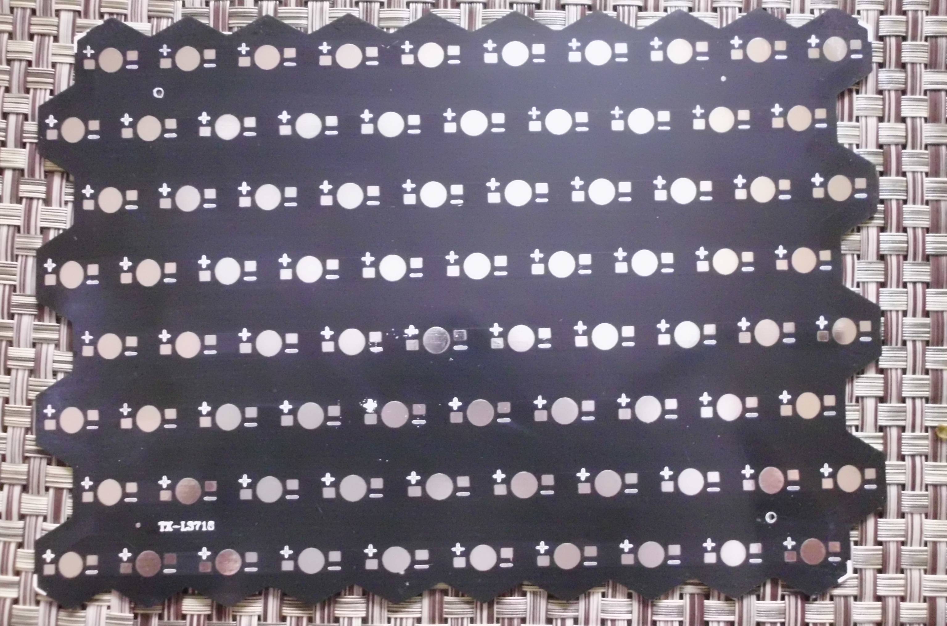

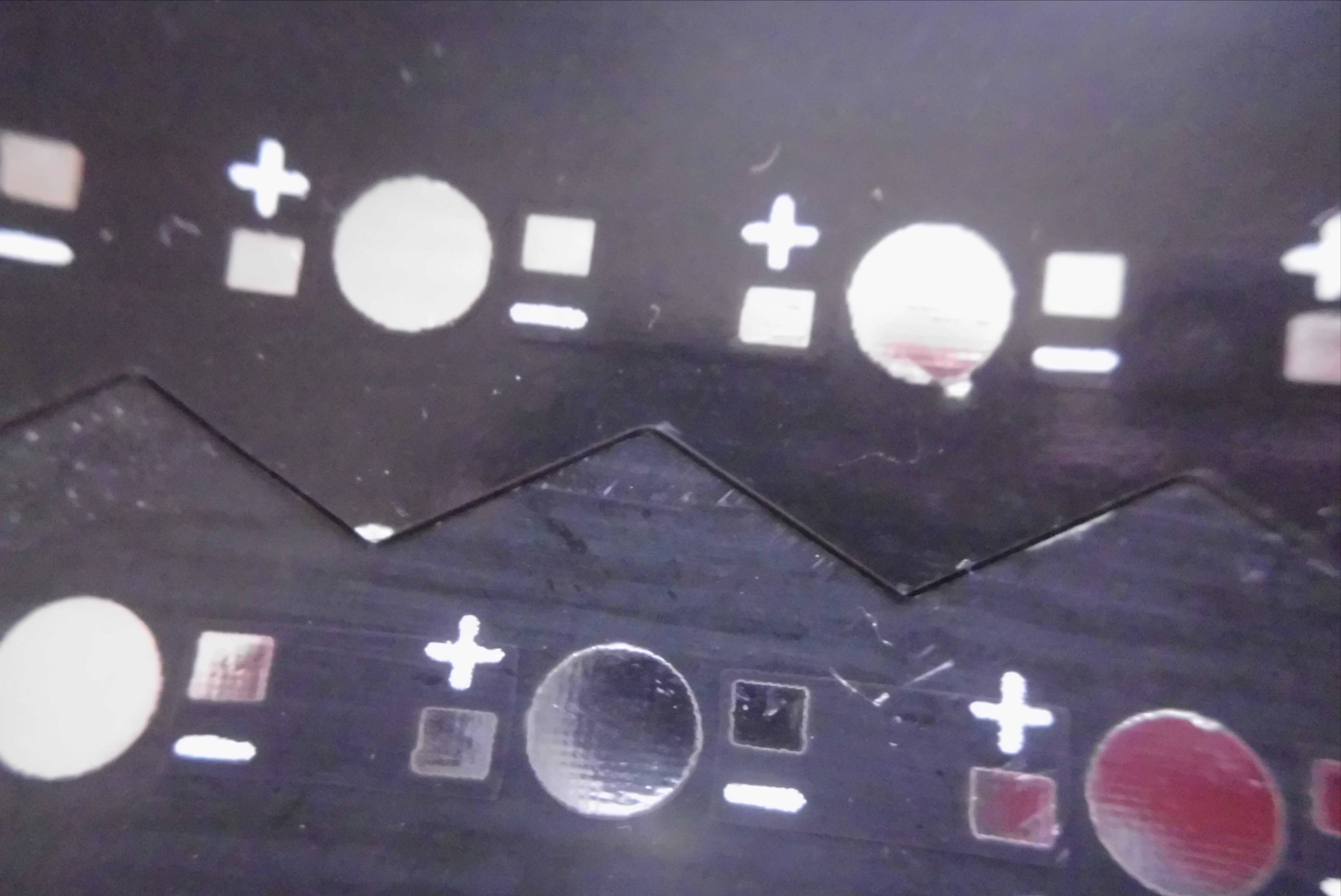

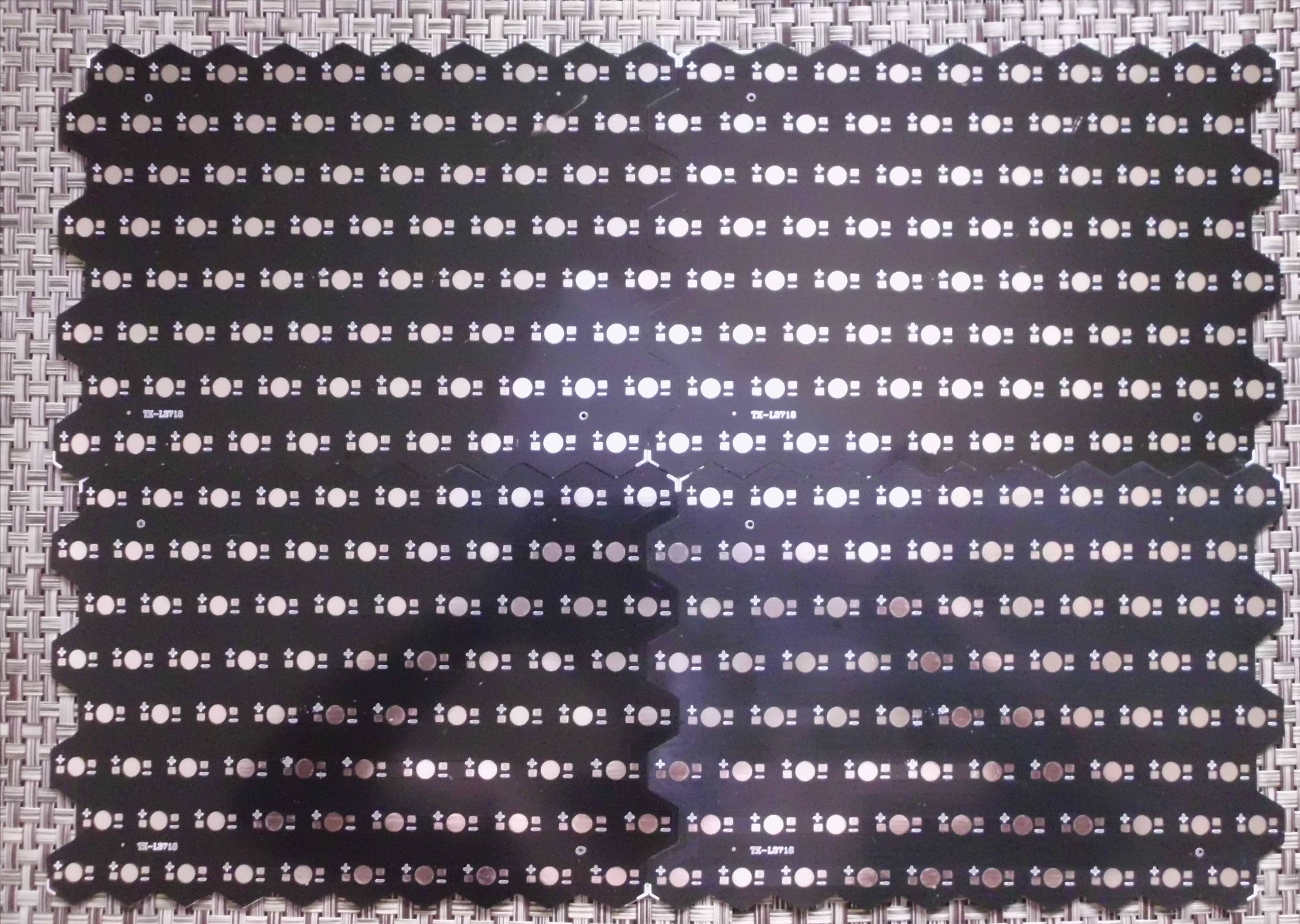

Got the Custom MCPCB's and LED's yesterday..
