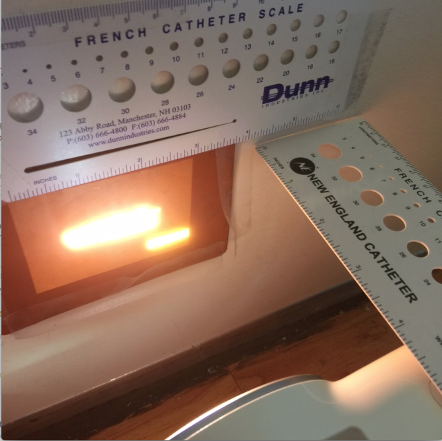

This is about the VIVITEK D859; Just Arrived; Out of the box Close-up focus-able distance is 100mm , Image Size 76mm x 60 mm + / - one mm; The image is too bright to be photographed properly at 3600 lumens.
